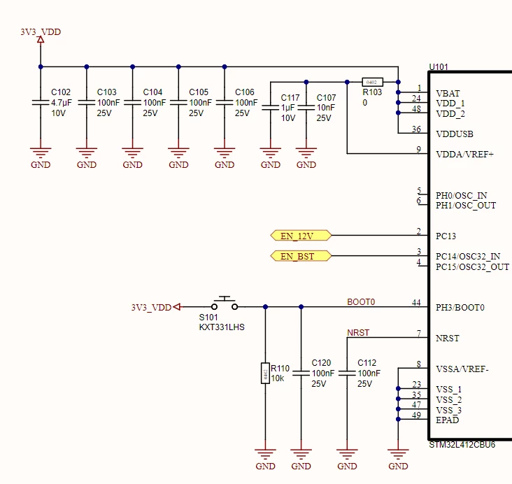

I'm trying to write a code to store some values at the final flash page (no. 63) of STM32L412 I succeeded into erasing the page, but I'm failing to write anything to it, the code is based on the reference manual (RM0394)

Establish the HAL examples work as expected, if they don't hand crafted ones are unlikely too either.
https://github.com/STMicroelectronics/STM32CubeL4/tree/master/Projects/NUCLEO-L412KB/Examples/FLASH/FLASH_EraseProgram
Which specific STM32L412 ? Any errors or status reported by the FLASH peripheral?
Is this a custom board? Running at what voltage? Check VCAP capacitors, and voltage.

I didn't notice that there is an example provided inside CubeL4 which I tested with my hardware, and it worked very well now :D, I'm not sure what was the error will investigate it more to understand why that was happening.
I'm using STM32L412CBU6 and powering from LDO 3.3Volt as attached and no VCAP in this case.
Thank you so much for your help and support.
