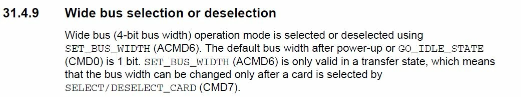

    Montassar BEN ROMDHANE_O
    Visitor II
    December 11, 2014
    Posted on December 11, 2014 at 15:04
    Here below some screen captures from the RM0090 reference manual:
    Regards,
    Heisenberg.
