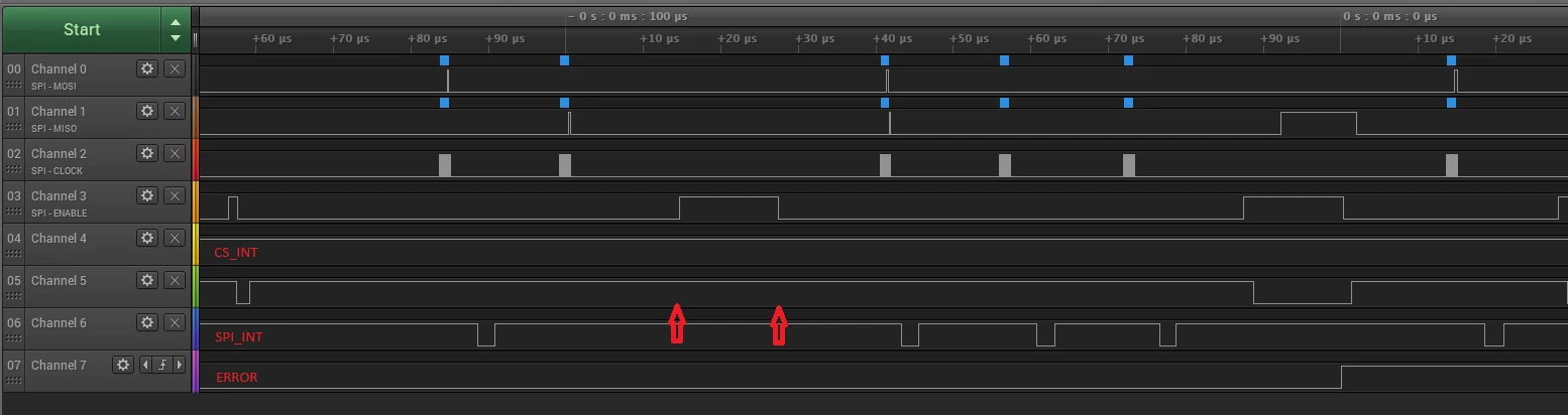

So in my Logic capture the slave should toggle LD2_Pin ech time the CS line is pulled. The ERROR_Pin should be toggled each time an SPI byte is received.
On the Master side I also have an ERROR_pin wich toggles when I detect something didn't work (further explanation coming later)
I tried both the HW CS and the SW CS for the slave - same problems on both [SW CS was implemented by using EXTI on CS PIN and use
SET/CLEAR_BIT(hspi->Instance->CR1, SPI_CR1_SSI)
1. Worst case: EXTI  + SPI interrupt is missing:

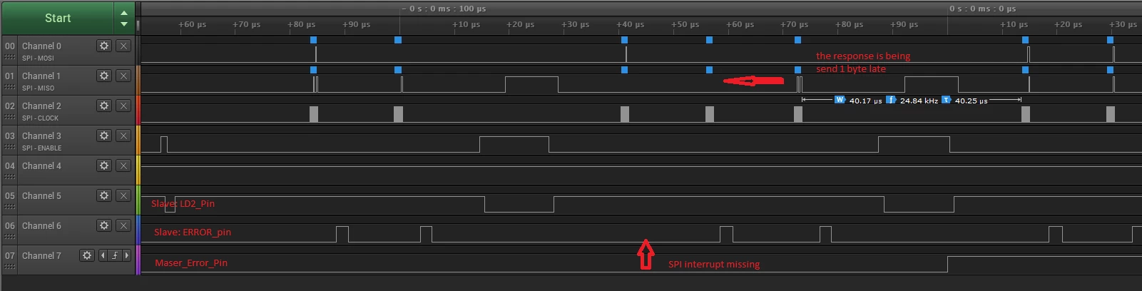

2. Here we can see how often this error occurs - when doing the 2 byte thing continusouly

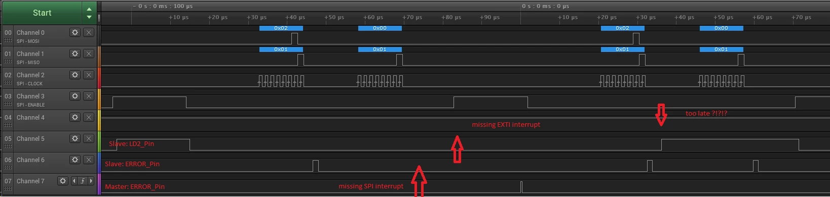

.3 In a more complex scenario sometimes just the SPI interrupt is missing:
Since this was a 2 byte read request - the answer in being send 1 byte too late and leads to corrupted data (0x0001 indead of 0x0101)

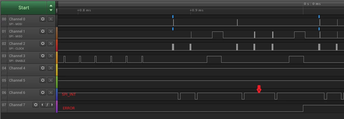

4. This also might happen in between:

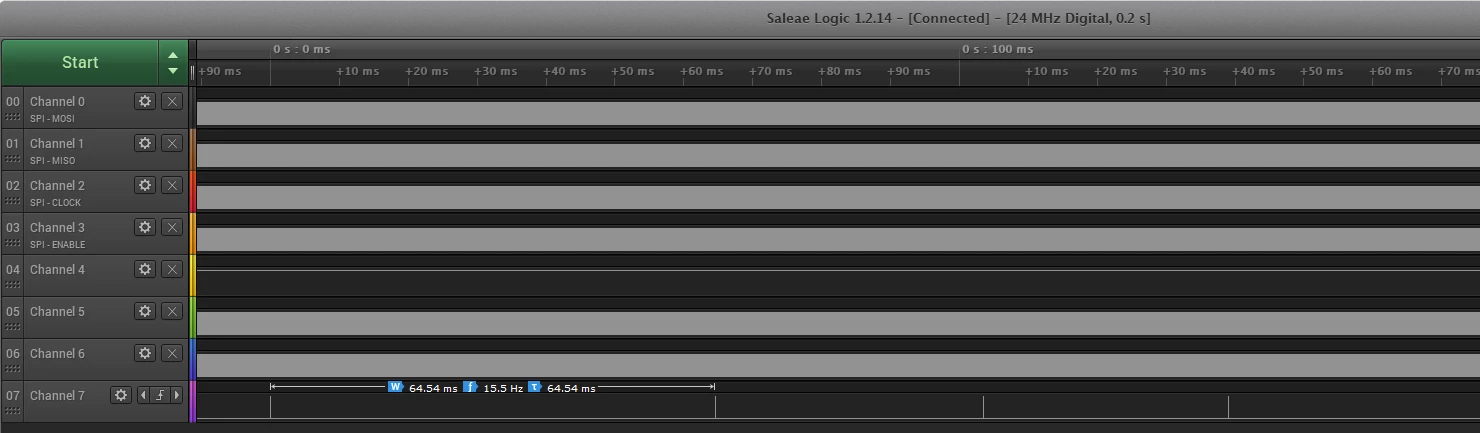

5. Or just the EXTIs are skipped andd SPI is totaly fine:
All in all it seems to me something is blocking interrupts - or the HAL might have some hickups.
