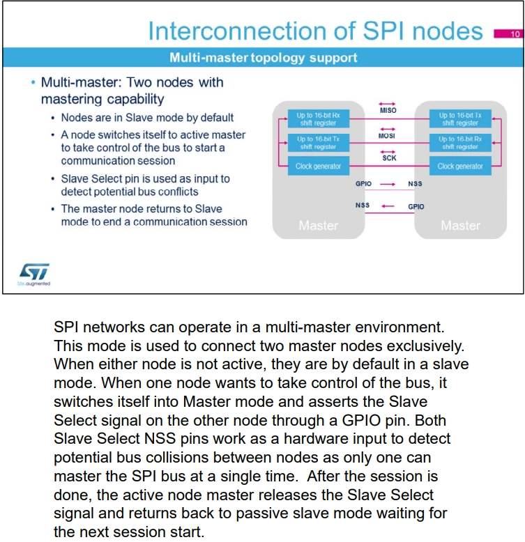

Hello
Im trying to implement stm32 spi multi-master function on a stm32f765 according to the below presentation
I keep getting MODF error when transmitting as a master, that would indicate that the slave sets the masters NSS pin low. Even if I set the NSS pin permantently high, by hooking it to a 3,3v pin , I get the same error!

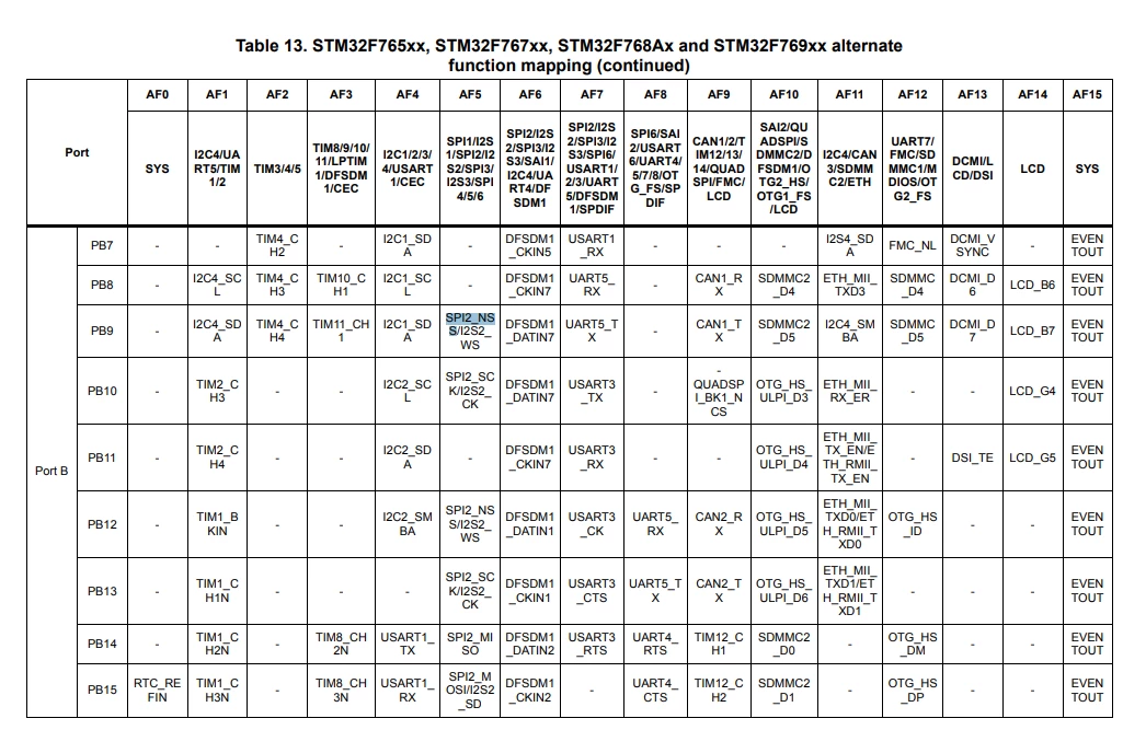

STM32Freakz
September 8, 2020
The setup is the one I pasted in the code, the SPI_CS_Pin refers to GPIO_PIN_9 and SPI_CS_GPIO_Port to port GPIOB
and alternate function in use is AF5 according to the table below0693W000003QzClQAK.png
  1. GPIO_InitStruct.Pin = SPI_CS_Pin;
  2. GPIO_InitStruct.Alternate = GPIO_AF5_SPI2;
  3. GPIO_InitStruct.Mode = GPIO_MODE_INPUT | GPIO_MODE_IT_RISING;
  4. GPIO_InitStruct.Pull = GPIO_PULLUP;
  5. HAL_GPIO_Init(SPI_CS_GPIO_Port, &GPIO_InitStruct);

waclawek.jan
September 8, 2020
> What am I looking for?
We are talking about PB9, so you want to look in MODER at bits 18 and 19 (i.e. 9*2 and 9*2+1 - two bits per pin are used), they are 0b00 which means Input, and are supposed to be 0b10 for AF. Then we would be looking at bits 4 to 9 in AFR[1] (4 bits per pin, that is 32 bits for pins PB0..PB7 in AFR[0] and 32 bits for pins PB8..PB15 in AFR[1].
Having no pin set to AF corresponding to the SPI2_NSS means, that internally that node is set to 0 - which immediately after enabling SPI switches it to slave mode.
> The reason why I set it to GPIO_MODE_INPUT and not GPIO_MODE_AF_PP was that I got strange behavior with the pin getting set half way (~2,2V / floating behavior), which disappeared when I set it to input.
I don't understand. If the PB9 is set as AF in MODER and AF5 in AFR[1], and SPI module is set so that NSS is input (i.e. SPI_CR2.SSOE=0), the PB9 pin works in exactly the same way as when it's set to Input. If not, some of those 3 things are not set in that way.
Do you have a pullup on that pin?
