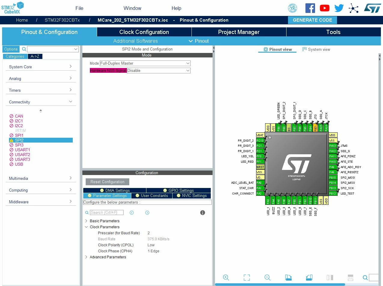

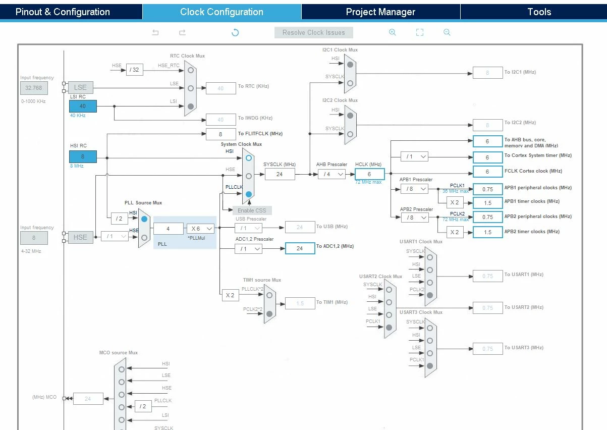

Hello and thanks for sharing these details.
I have some doubts about the clock configuration. You can refer to the provided examples (SPI) within STM32F3Cube package and follow the same clock config.
It can help you!
Regards,
Amira
SLONK.1
SLONK.1Author
July 8, 2021
Sir,
I'm using STMCubeMx to configure the clock. STM32F3Cube is a package as I know, How can it help me ? How to follow what you are calling "same clock config".
Regards.

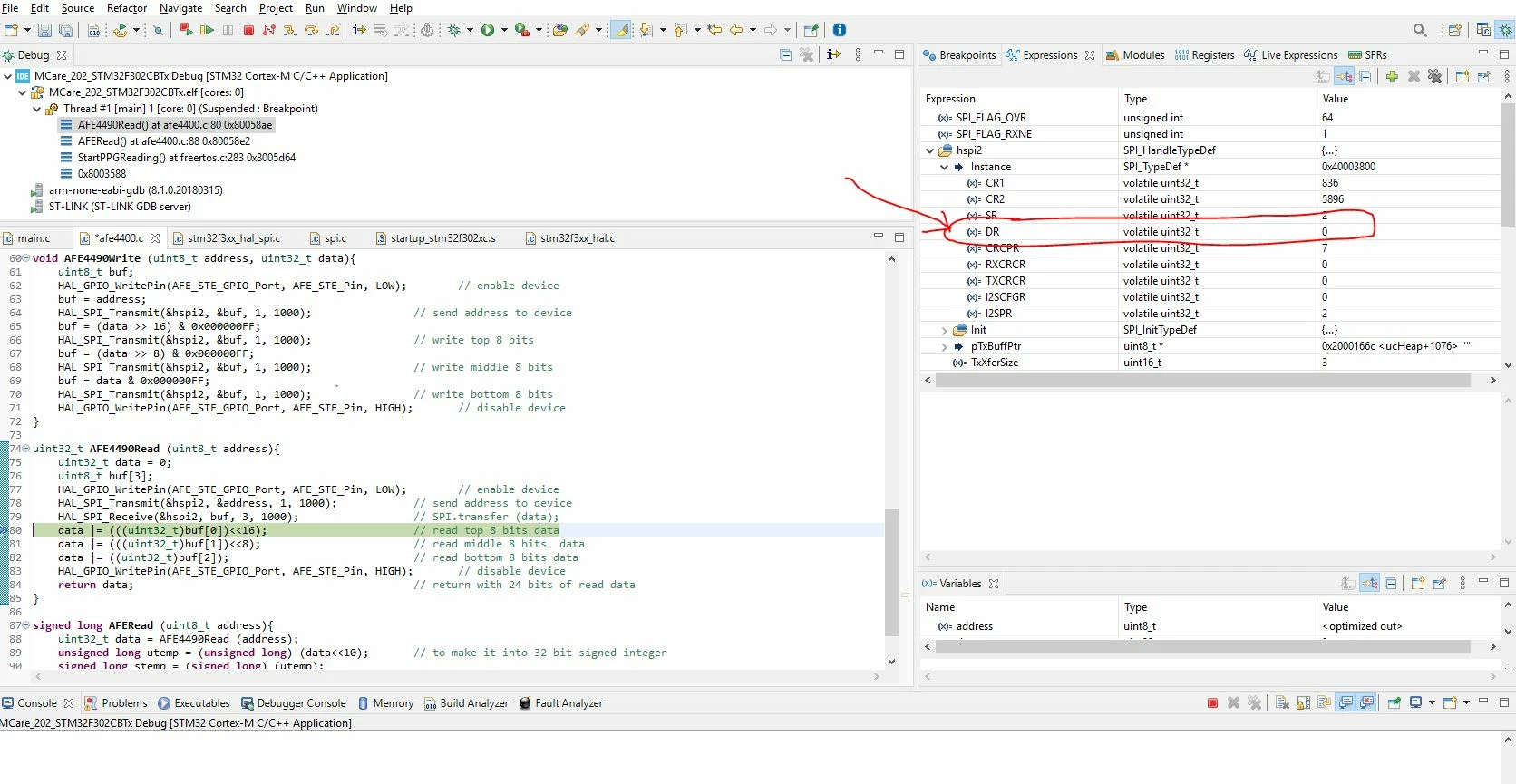

July 8, 2021
Monitoring DR has consequences. If your debugger reads data, it won't be read by your program.
How do you know the data on the line isn't 0? Can you show a scope plot of it?
SLONK.1
SLONK.1Author
July 8, 2021
Yes I know but when I monitor the same code on STM32L476VETx, I got data and it works fine. So I don't think it is the reason. You can check on the image the value of DR (not 0) when using it. So I think it is not the problem. For the data on the line, I don't know. May be I should find a scope to plot it; I don'h have a scope.
