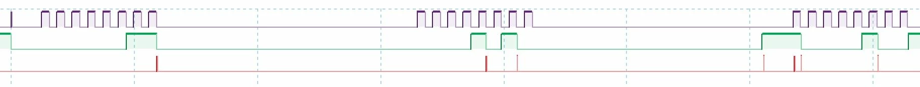

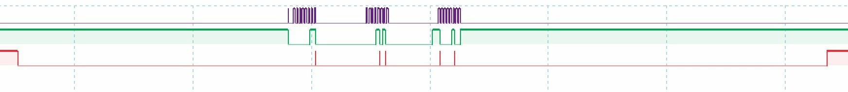

I am using SPI function in Nucleo F411RE.
I use PicoScope to capture SPI signals as showed below:0693W00000D1Ax2QAF.jpg0693W00000D1AxCQAV.jpgThe bottom line is Chip Select (CS). How come there is some random spike when it is supposed be kept low.
My code is showed in the following lines:

waclawek.jan
July 31, 2021
Probably poor grounding/return.
Also you can try to decrease the SCK/MOSI slew rate/GPIO drive (GPIO_OSPEEDR setting).
HDaji.1
HDaji.1Author
Senior
July 31, 2021
I only connect SPI pins to PicoScope pins, I didn't forget to connect GND pin. No slave connection yet.
Where to set GPIO_OSPEEDR setting?
HDaji.1
HDaji.1Author
Senior
July 31, 2021
BTW, I tested a case where spi_transmit is not called. I just toggle the CS pin in fast speed (us gap). There is no spike.
waclawek.jan
July 31, 2021
I see above more signals to change at the same time. Try toggling more pins at once.
As I've said, the slew rate of the signals edge is what matters here, not pulse length.
I don't know, this is your program. I don't use Cube. Probably where other attributes of given pin are set.
