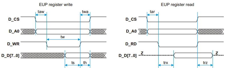

Hi. All!
I want to use FSMC module, but I'm not sure that it settings correct. There is write operation on a picture. I see multiple NWE activation. And sometime it release NEx together NWE (should be NWE and than NEx). What should I do for diagram like Figure 437 from
http://www.st.com/st-web-ui/static/active/en/resource/technical/document/reference_manual/DM00031pdf?s_searchtype=keyword
? Or, possible, I don't understand something? 0690X00000602yqQAA.jpg Code:

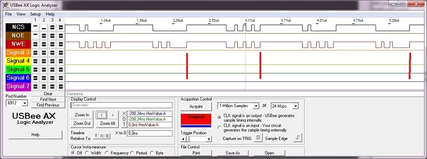

At 24 Msamples per second you are probably not capturing single write pulses - if you run the mcu at 168MHz, they should last around 40ns. Show us also the capture of your ''marker'' signal, not hand-drawn lines.
Also, I don't speak the library gobbledygook, but it appears to me that you set FSMC for multiplexed memory but you don't initialize FSMC_NL, I suspect you do this in error.

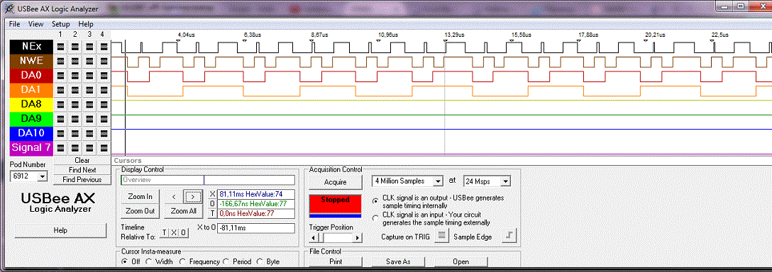

Posted on November 26, 2014 at 03:55
Thank you! You was right - samplerate was too low. It worked on default frequency - 16MHz HSI (not 168MHz, of course! ), but samples couldn't show all details. For 16MHz need 32MHz sample frequency minimum (as told Nyqist and Kotelnikov).
I added
RCC_HCLKConfig( RCC_SYSCLK_Div4);
// make it slow
and now I have this one.
Black - NEx,
red
- NWE,
brown
- soft strobe (see source upper):
Hah! I can do the same over registers, but library (SPL) do writing code simplier and help me study new MCU faster. Possible, code using library isn't readable for you - sorry.
but it appears to me that you set FSMC for multiplexed memory but you don't initialize FSMC_NL, I suspect you do this in error. Can you explain it more detail? What means 'multiplexed' for FSMC? In my appinion, it means that data and address used the same wires. No? Not only? When need FSMC_NL signal? I don't need it really. But ,if FSMC_NL can separate address and data - it will be great! Now I want to use just A8 bit.

> now I have this one
And what's wrong with it?
Roughly, yes. So, you need some way to distinguish between data and address. That is the purpose of FSMC_NL - it is supposed to drive a latch which latches the addresses before data are read/written. Read the manual.
> I don't need it really.  Now I want to use just A8 bit.
Then don't use the multiplexing mode.

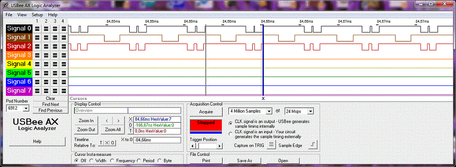

I can't do it still! Agrh...
So, I need ModeA or ModeD. It means, I should use extended mode and write timings in both BTR1 and BWTR1 ( bank 1 for NOR/PSRAM). I declare structure for IO:
#define
M_BASE ((uint32_t)(0x60000000))
#define
MADDR ((uint32_t)((0x60000000 | 0x100)-4))
#define
M_ADDR ((Modem_TypeDef *) MADDR) So, now I can write there:

It is works but not full! As I know, pin PE11 (DA8) must be output for the lowest address bit when I select MUXEN=0x0 and MWID=0x0 (equ 8bit). Right? But logic analyser show me - wire doesn't changed! In multiplexed mode it changed address but started value is 'full in 1', then 00, 01,... I haven't idea anymore! 0690X0000060MmuQAE.gif I want to connect 8bit devise just. Why is it so difficult? 0690X00000604xZQAQ.png

That has nothing to do with English; it's simply a prime example of the inferior quality of STM32 documentation.
Note, that that table's title is ''example of supported memories and transactions''. I guess it comes from some preliminary internal/promo material to the FSMC IP module, and IMO it should've never appeared in the manual, and serves only to confusion.
Of course you can use 8-bit SRAM.
