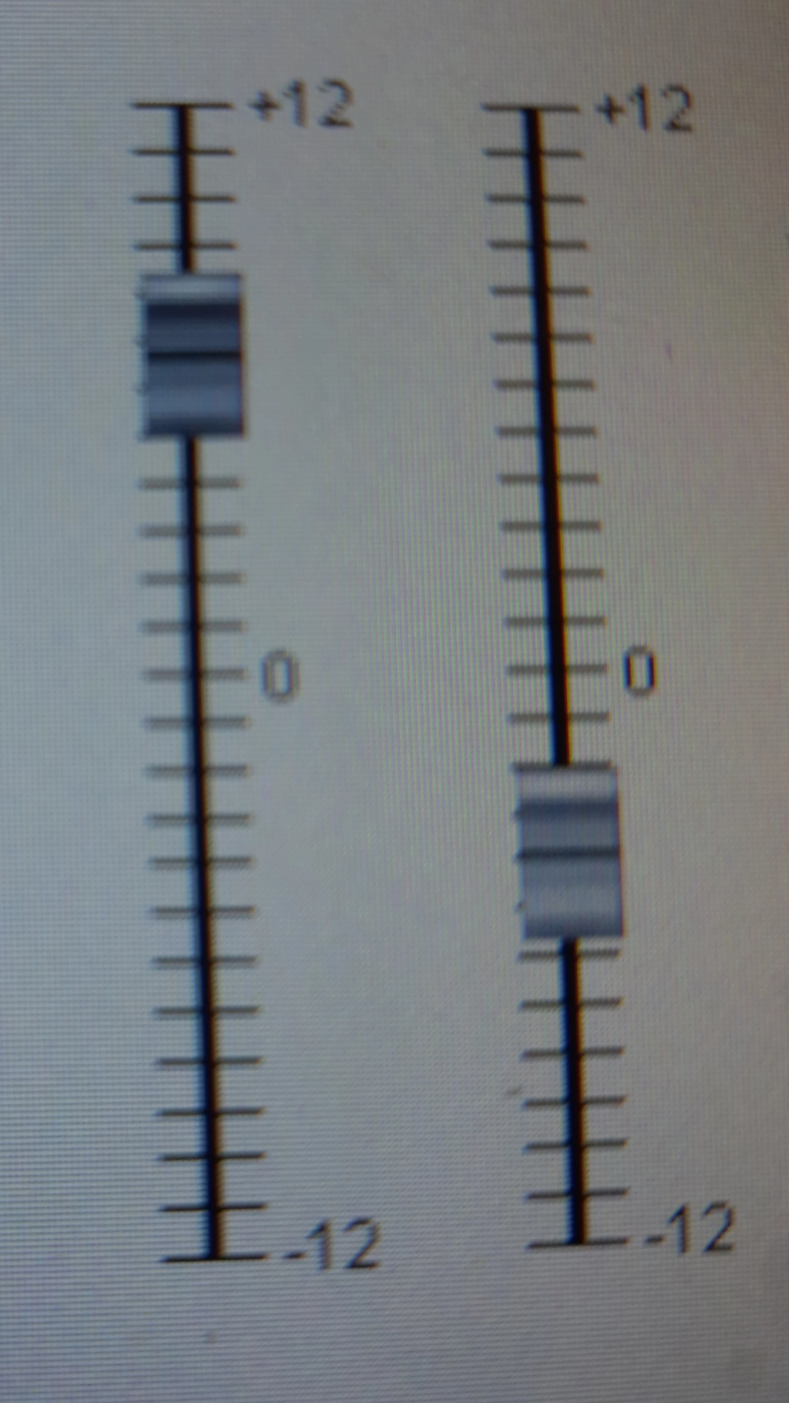

0693W000000UjCvQAK.jpgHere my solution to create a slidebar on this evaluation board, it should run also in other STM32 modules.

void BSP_LCD_CreateSlideBar(slidebar_Struct *, uint8_t *, uint8_t *, int, uint16_t);
> 2 parameter the pointer to the slibar image
> 3 parameter the pointer to the cursor image
void BSP_LCD_CreateSlideBar(slidebar_Struct * s, uint8_t * slide, uint8_t * cursor, int pos, uint16_t perc)

void BSP_Pointer_Update(void)
	static TS_StateTypeDef prev_state; /*previous touch state from the touch sensor used from BSP package*/
	TS_StateTypeDef ts; /*actual touch state from the touch sensor used from BSP package*/
	int xDiff, yDiff; /*difference in postitions between touch states*/
	BSP_TS_GetState(&ts);
	xDiff = ts.touchX[0] - prev_state.touchX[0];
	yDiff = ts.touchY[0] - prev_state.touchY[0];
	if (prev_state.touchDetected != ts.touchDetected)
 prev_state.touchDetected = ts.touchDetected;
		if ((ts.touchX[0] != 0) && (ts.touchY[0] != 0))
		 prev_state.touchX[0] = ts.touchX[0];
		 prev_state.touchY[0] = ts.touchY[0];
	else if (yDiff > 5 || yDiff < 5)
		if (ts.touchX[0] > slidestr1.cursor_start_x && ts.touchX[0] < slidestr1.cursor_end_x &&
 	ts.touchY[0] > slidestr1.cursor_start_y && ts.touchY[0] < slidestr1.cursor_end_y)
			if (yDiff < 100 && yDiff > -100 && yDiff != 0)
 	 BSP_LCD_CreateSlideBar(&slidestr1, (uint8_t *)(&slide1), (uint8_t *)(&cursor1), yDiff, 0);
 	 LCD_LOG_State("Cursor 1 now at position %d%%", slidestr1.curr_pos);
		if (ts.touchX[0] > slidestr2.cursor_start_x && ts.touchX[0] < slidestr2.cursor_end_x &&
 	ts.touchY[0] > slidestr2.cursor_start_y && ts.touchY[0] < slidestr2.cursor_end_y)
 	 BSP_LCD_CreateSlideBar(&slidestr2, (uint8_t *)(&slide1), (uint8_t *)(&cursor1), yDiff, 0);
 	 LCD_LOG_State("Cursor 2 now at position %d%%", slidestr2.curr_pos);
