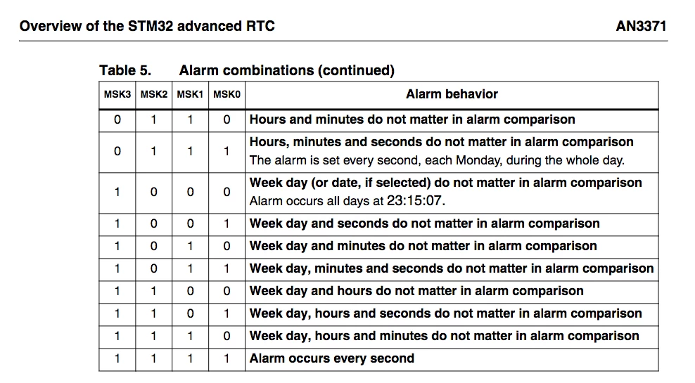

Hi
I was running RTC with stm32f I use cmsis and using LSE(768 khz) for rtc.
I want to trig the RTC_IRQ on each second. How can I active it ? Its my code for adjusting rtc
static void RTC_Config(void) {  RTC_TimeTypeDef RTC_TimeStruct;  RTC_InitTypeDef RTC_InitStructure;  NVIC_InitTypeDef NVIC_InitStructure;    /* Enable the PWR clock */  RCC_APB1PeriphClockCmd(RCC_APB1Periph_PWR, ENABLE);      /* Allow access to RTC */  PWR_BackupAccessCmd(ENABLE);    /* Reset RTC Domain */  RCC_BackupResetCmd(ENABLE);  RCC_BackupResetCmd(DISABLE);    /* Enable the LSE OSC */  RCC_LSEConfig(RCC_LSE_ON);     /* Wait till LSE is ready */   while(RCC_GetFlagStatus(RCC_FLAG_LSERDY) == RESET)  {}    /* Select the RTC Clock Source */  RCC_RTCCLKConfig(RCC_RTCCLKSource_LSE);      /* Configure the RTC data register and RTC prescaler */  /* ck_spre(1Hz) = RTCCLK(LSI) /(AsynchPrediv + 1)*(SynchPrediv + 1)*/  RTC_InitStructure.RTC_AsynchPrediv = 0x7F;  RTC_InitStructure.RTC_SynchPrediv = 0xFF;  RTC_InitStructure.RTC_HourFormat = RTC_HourFormat_24;  RTC_Init(&RTC_InitStructure);    /* Set the time to 00h 00mn 00s AM */  RTC_TimeStruct.RTC_H12 = RTC_H12_AM;  RTC_TimeStruct.RTC_Hours = 0x00;  RTC_TimeStruct.RTC_Minutes = 0x00;  RTC_TimeStruct.RTC_Seconds = 0x00;   RTC_SetTime(RTC_Format_BCD, &RTC_TimeStruct);   ///////////////////////////////////////////////////////////////////////////////////////////////////////    /* Enable AlarmA interrupt */  RTC_ITConfig(RTC_IT_TS, ENABLE);        /* Enable the RTC Alarm Interrupt */  NVIC_InitStructure.NVIC_IRQChannel = RTC_IRQn;  NVIC_InitStructure.NVIC_IRQChannelPriority = 0;  NVIC_InitStructure.NVIC_IRQChannelCmd = ENABLE;  NVIC_Init(&NVIC_InitStructure);    RCC_RTCCLKCmd(ENABLE); // Enable RTC  RTC_WaitForSynchro(); }�?�?�?�?�?�?�?�?�?�?�?�?�?�?�?�?�?�?�?�?�?�?�?�?�?�?�?�?�?�?�?�?�?�?�?�?�?�?�?�?�?�?�?�?�?�?�?�?�?�?�?�?�?�?�?�?�?�?�?

Thanks for reply
How can I define this mask combination? Can you give the code?
john doe
Senior III
October 16, 2017
Posted on October 16, 2017 at 20:00
I don't use the SPL, I use the HAL.  In the HAL its part of your alarm initialization struct.  Probably in the SPL, too.  Read the app note and look at how the alarm struct is defined in the header file you use.
