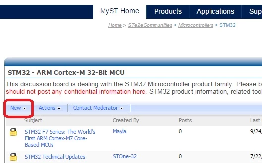

Starting new threads, click ''New'' in top left immediately above the list of posts.
