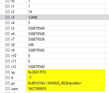

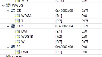

program counter is hitting WWDG_IRQHandler without enabling the Watchdog. what could be the problem/ cause for this
  • June 28, 2021
  • 3 replies
  • 6246 views
please find the attached register values of WWDG register on Reset position
Regards,
Sudheer

This can be a common handler for all interrupts for which you haven't written a handler, so it can be a hardfault too.

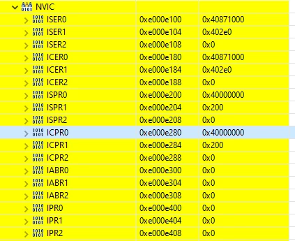

Skuma.12
Skuma.12Author
June 28, 2021
Hi DeLorean,
Thanks for your reply.
Checked NVIC registers status, but there is no pending interrupt, please find the attached values for your information.
Is there any thing need's to check apart from Handler spelling and NVIC
Regards,
Sudheer
Skuma.12
Skuma.12Author
June 28, 2021
June 28, 2021
VECTACTIVE bits will show what the currently active interrupt. Probably it isn't WWDG.

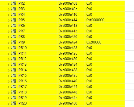

Skuma.12
Skuma.12Author
June 29, 2021
can you help us with the attached values
