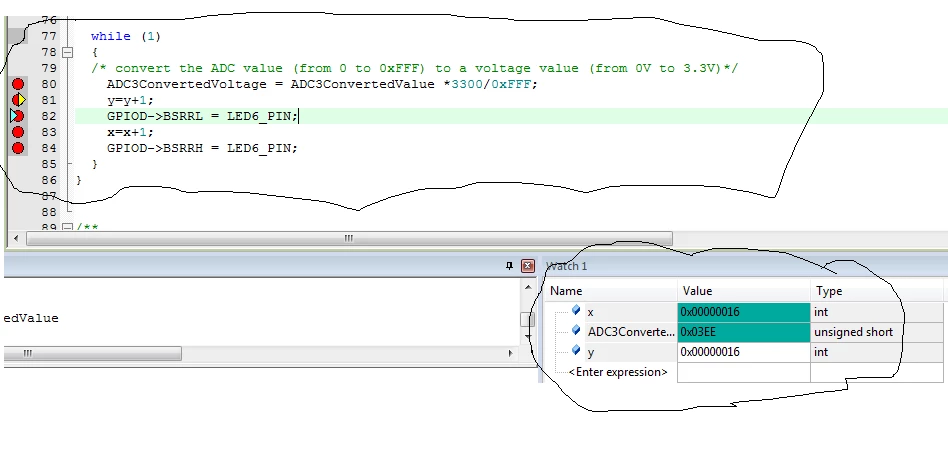

I bought a development board STM32F4 discovery. I wanted to try the debug and I modified the example ADC3_DMA in STM32F4-Discovery_FW_V1.1.0 in this mode: 0690X00000605UVQAY.png but the program does not stop never on the breakpoint at lines 80, 82 and 84 (ADC3ConvertedVoltage = ADC3ConvertedValue *3300/0xFFF; GPIOD->BSRRL = LED6_PIN; GPIOD->BSRRH = LED6_PIN;) but only at lines 81 and 83 (x=x+1; y=y+1;) has someone already had a similar problem?and can give me suggestions? thanks if shoud to be help I have attached the main

has someone  already had a similar problem?  and can give me suggestions?
Turn OFF optimization.

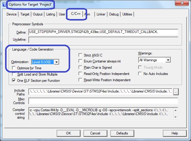

Thanks Clive1 but I don't understand, what is the turn off optimization?
Tesla DeLorean
Guru
November 10, 2013
Posted on November 10, 2013 at 17:54
In order to see linear and simplified code flow you need to turn optimization off so that the compiler does not reorganize your code. Alternatively you can look at the disassembly window and the flow of the instructions generated, but don't always expect line level equivalence. Instead of breakpointing everything use the step in, step over, step out buttons.

Thanks Clive1. now work correctly.
