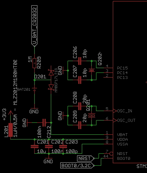

I designed a circuit that contains a CR2032 Battery for backing up the RTC.
The circuit is shown below.
Without the battery the RTC is running well and an initialize of the RTC is no Problem.
After inserting the battery the controller won't startup anymore.
The program hangs while the RTC is initialize. The function is waiting that the RTC registers will be syncronized. But the RSF Bit will be never set.
If i remove the battery the RSF Bit is immediately set.
I also tried to connect VDD directly to the VBAT Pin, but that results in the same situation, the RTC is not working and the program is hanging.
Is there something that i have forgotten to do?
I already tried to searched the REF manual but without success.0690X00000606FfQAI.png

    Post  code.
    Markus Sierpinski
    February 6, 2017
    Posted on February 06, 2017 at 11:33
    Ok, no problem. I will post the RTC Init funciton.
    The system is stopping at the read line.

    IMO LSE stopped running while BKP_DR1 retained its content.
    [EDIT] test this hypothesis by removing battery, shorting VBAT to GND (shorting the 100nF cap on it), replacing battery, trying to run the code

    when i remove the battery the RSF of the RTC register is immediatly set.
    And the program is working.
    Also without a battery and the shorted cap everything is running well. Putting the battery back to its holder will cause the described stop of the program.
    I also thinked allready about a not running LSE when the battery is inserted.
    I hope that i will get my oscilloscope back tomorrow to test the LSE input.
