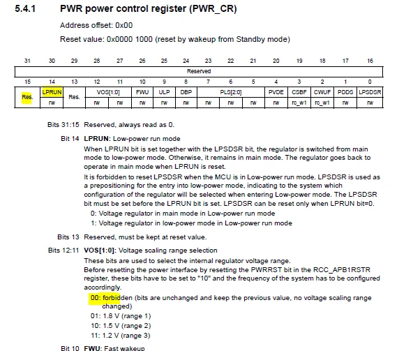

In fact, w
hen I use the __HAL_PWR_VOLTAGESCALING_CONFIG function with PWR_REGULATOR_VOLTAGE_SCALE3 for
a
low frequenc
y (lower than 4MHz)
, this instruction
stops the
execut
ion
, while this function is executed for the two other
ranges
(PWR_REGULATOR_VOLTAGE_SCALE1 and PWR_REGULATOR_VOLTAGE_SCALE2). I tried to change the value of this variable
(PWR_REGULATOR_VOLTAGE_SCALE3)
from
PWR_CR_VOS (
0x00001800
to 0x0000C000. With this setting, the function runs.
P
lease, is it possible to check if there is an error
in the
definition
of this value?

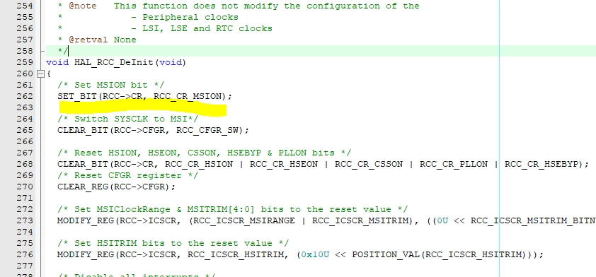

In the other hand
, the HAL_RCC_DeInit
function
does not execut
e
. Indeed,
the
execution
is stopped
in
the function of switching the SYSCLK to MSI
(CLEAR_BIT(RCC->CFGR, RCC_CFGR_SW);)
. When, I
change this function CLEAR_BIT
by
SET_BIT
function
and change the order of the 4
th
instruction (Reset CFGR register) before
the instruction switch SYSCLK to MSI, the code is executed and the sleep mode
outperforms
the normal mode
in terms of energy consumption
    from
    PWR_CR_VOS (
    0x00001800
    This setting leaves VOS unchanged , sets the reserved bit 15 and also sets LPRUN  bit14
    For the second part of your question:
    Please, can you verify if there are some problems in the function HAL_RCC_DeInit
    It seems that HAL_RCC_DeInit function sets as systemclock the MSI , whithout check for MSIRDY flag in the RCC_CR register. Yes i thing this is a problem .

    Hello Vangelis,
    According to the RM0038 Reference manual, I agree with you that
    changing the value of the variable
    from
    PWR_CR_VOS (
    0x00001800
    to 0x0000C000, leaves VOS unchanged, sets the reserved bit 15 and also sets LPRUN  bit14. But, the __HAL_PWR_VOLTAGESCALING_CONFIG function using PWR_REGULATOR_VOLTAGE_SCALE3 (0x00001800) stops the execution. Thus, I think that there is an error in the definition of this value.
    Vangelis Fortounas
    October 4, 2017
    Posted on October 04, 2017 at 15:59
    Hello again!
    I checked the
    __HAL_PWR_VOLTAGESCALING_CONFIG and according to RM sets or clears the VOS bits.
    I will try later to find why stops the execution .I have a board with L152.
    It would help a lot if you post  some code here. Like an .IOC file and main func .
    Regards
    vf
    Technical Moderator
    October 4, 2017
    Posted on October 04, 2017 at 11:56
    Hello Wassim,
    Your reported issue about
    HAL_RCC_DeInit
    function
    is raised internally for further review.
    All your comments and suggestions are welcome to improve our solutions.

    Technical Moderator
    November 22, 2017
    Posted on November 22, 2017 at 12:40
    Thank you Luca, this issue is already raised internally to the developer team for fix.
    Best Regards
    Imen
