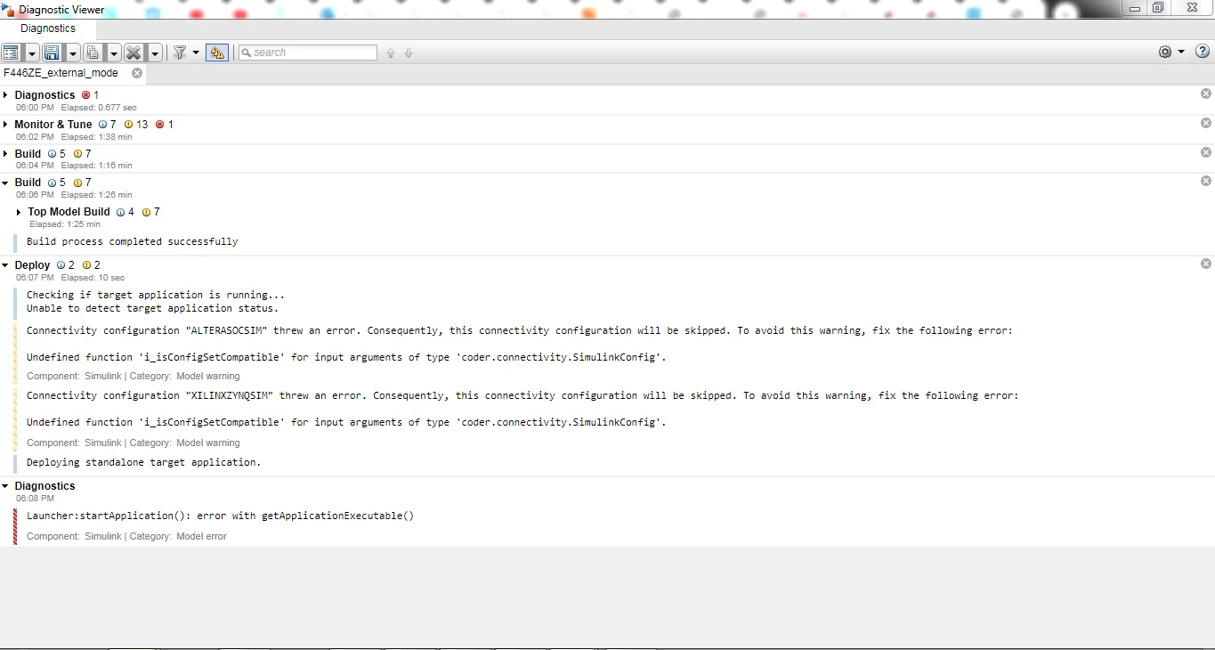

Hello, Thankyou for the reply, Actually I am trying to run the external mode demo file provided by stm MAT-TARGET for the nucleo F446ZE LQFP144 as I also have the same board. But whenever I am running and "Build deploy and start" it is giving me the following error, I thought it is because of no proper connection of USARTs, but now I checked my USARTs as well, they are functioning properly. Do you have any idea what is the cause of this error? I am using MATLAB2020a, is this version of MATLAB causing the error?
I am using 2 USARTs (USART2 for PIL and USART3 for external mode).
