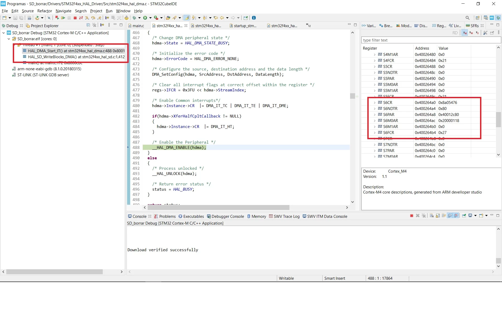

Hello again, I have found a workaround to the problem. The ADC is working properly. The problem is with the built-in HAL procedures for SDIO. For convenience and after much trial and error, I am using both DMA channels, although it is not essential, I do not need them for other jobs yet. When you write a block to SD with the HAL_SD_WriteBlocks_DMA function, the result is quite strange (even after fixing it). At the end of the function we find:
 /* Enable SDIO DMA transfer */
 __HAL_SD_DMA_ENABLE(hsd);
 /* Enable the DMA Channel */
 if(HAL_DMA_Start_IT(hsd->hdmatx, (uint32_t)pData, (uint32_t)&hsd->Instance->FIFO, (uint32_t)(BLOCKSIZE * NumberOfBlocks)/4U) != HAL_OK)

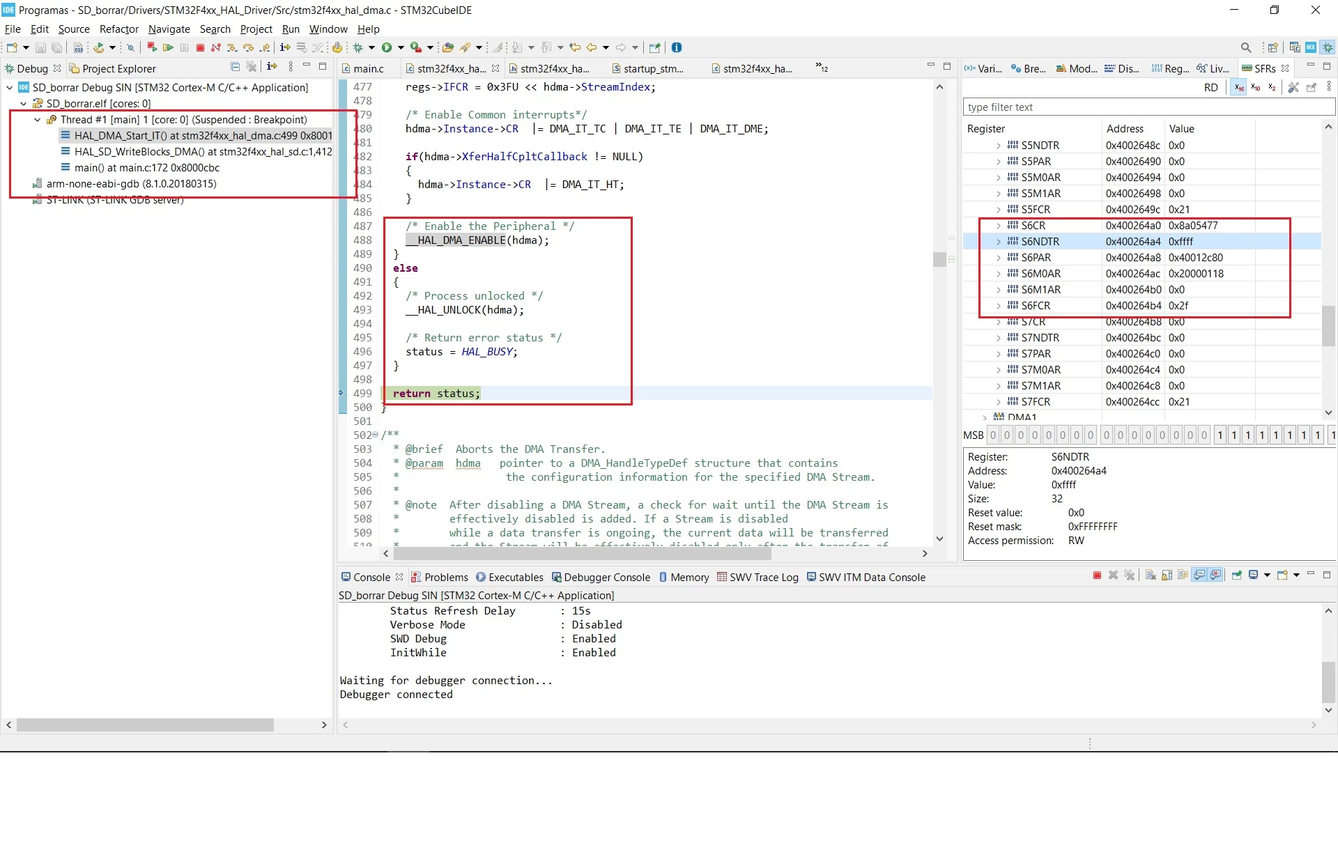

When it calls HAL_DMA_Start_IT, the DMA that was prepared to send 0x80 words, happens to have in the counter 0xFFFF, so it has sent all the prepared information to SDIO and (which is even more strange) one more word.
0693W000008G5UKQA0.jpgAfter activating the DMA, this happens:
0693W000008G5UUQA0.jpgPossibly this error is caused by some defects in the F411 hardware, the known ones are described in the Errata sheet.
The truth is that the DMA should have waited for SDIO to start requesting data from it, then the SDIO data request signal is active when it is disabled.
My workaround has been to program SDIO first and program and activate DMA later.
