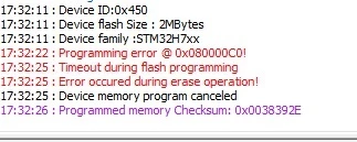

I have a problem with programming the STM32H755iit
- Jtag gives an error

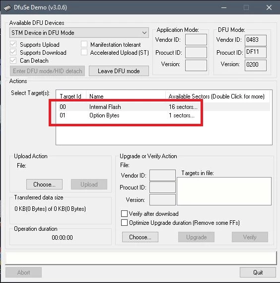

- DfuSe 3.0.6 Demo sees very few internal sectors, and hungs instantly

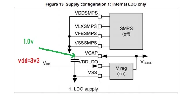

The SMPS is off, and I connected this like this: see picture
The CAP reads 1.0 volt
VDDLDO_1 = 3v3
VDDLDO_2 = 3v3
VDDLDO_3 = 3v3
PDR_ON pullup 3v3
It seems I cannot access the internal Flash memory
Anyone an idea why?

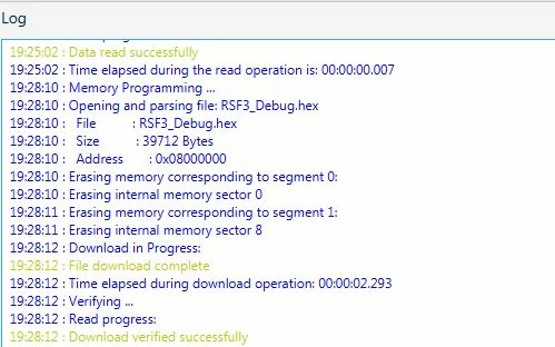

DfuSe demo is very old compared to the H7 design/release, arguably the development has been deprecated in favour of newer tools.
Try using the USB/DFU mode in STM32 Cube Programmer

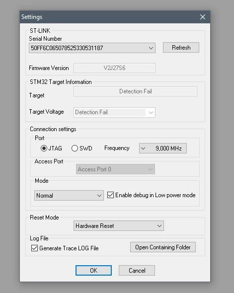

I use the STLINK with this settings :

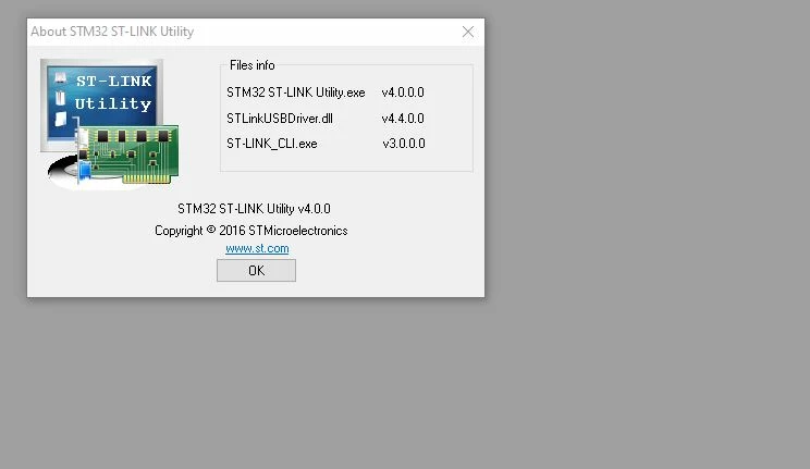

0693W000007ZVdgQAG.jpgi use this STM32 ST-LINK utillity 0693W000007ZVcnQAG.jpg

The ST-LINK Utilities have also been deprecated in favour of STM32 Cube Programmer
I think this is a pity, but nevertheless it is the state of affairs.

0693W000007ZVlLQAW.jpgIt's seems better..
Hans T
Hans TAuthor
February 26, 2021
thanks for your help.
