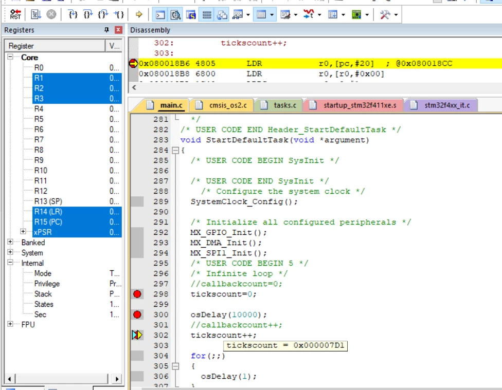

I have initialized the kernel first, and called HAL_Init() and SystemClock_Config() within the OS task - StartDefaultTask, the osDelay is not blocking the StartDefaultTask until the specified number of ticks.
configTICK_RATE_HZ is set to 1000 Hz (1 ms).
when osDelay(10000) --> the task is blocked for 2002 ticks and the task execution resumed.
when osDelay(5000) --> the task is blocked for 1001 ticks and the task execution resumed.
Clock configuration:

Please tell us the rationale behind wait time being scaled when System Clock configuration and HAL are called after starting the OS Kernel.

Hi @cchan.3 Could you tell where have you found an example where HAL_Init() and SystemClock_Config() are called in a task, rather than before initialization of RTOS (by the way which RTOS you're using)?

I didn't find it anywhere. I am just trying to understand what happens when it is called inside a task.
Pavel A.
August 28, 2023
@cchan.3  As you see, nothing good happens. There are examples with RTOS, please refer to them.
