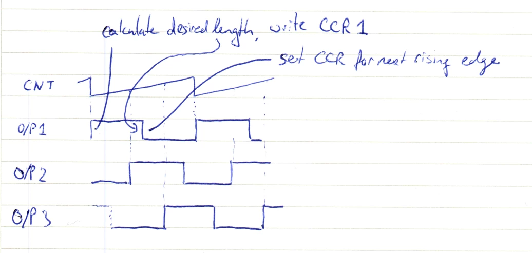

The goal is to calculate how long a pulse needs to be directly after it has started. This is for some control algorithm:
0693W00000GWQSnQAP.pngFor each of the 3 outputs the start is 120 degrees delayed. The length of output is to be controlled individually. Eventually, something similar needs to be done with TIM8, but 60 degrees out of phase with TIM1.
