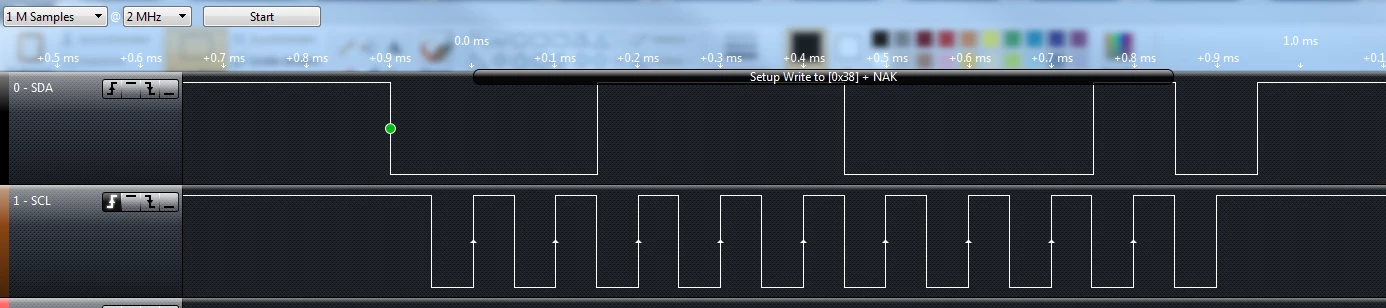

Hello, I'm trying to communicate with a slave device (Adafruit TSL2561, I²C-Address: 0x39). I made a fast project using STM32 CubeMX and adapted it. However, the output of the Pins is not correct, see the attached screenshot (Addr. 0x38 instead of 0x39). Can anyone tell me what I did wrong? Thank you in advance!

    Bit 0 normally denotes Read/Write and is not an Address, perhaps if you're using a 7-bit address you need to left shift it by 1

    Is there something wrong with I2C initialization?
    No idea, I'm not supporting HAL/CUBE code. I don't see any pin configuration code, you'd need to configure the pins correctly in OD (Open Drain) mode, and you'd need an appropriate external interface with pull-up resistors. Your analyzer output looks promising, but with I2C the lack of an ACK to an output address suggests the part you're talking too isn't hearing you. Check your supply and grounds, and SCL/SDA connectivity to the correct pins, and any address select pins on the I2C device.

    0x39 *2 = 0x72
    0x29 *2 = 0x52
    0x49 *2 = 0x92
