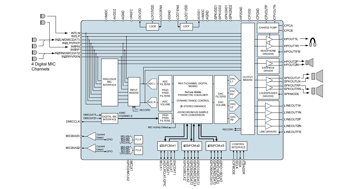

I can utilize the DAC with no problem. In my original post I wrote that I can send a generated 1 KHz square wave to the input, and see the signal at the output but not without a lot of noise.
I am wondering if this is an issue with how the 35G-DK audio-input jack is connected. The schematic has the L/R inputs of the jack going to the LN and RN pins. Which apparently go through the analogue mic (PGA?) interface. I Wonder if this is the issue.
Enabling the DRC allows the signal to pass through but again not without a huge amount of noise.
I've tried to disable the +30dB (why would you need +30dB gain) gain on the input mixer to no avail.
Again I am wondering if this is a hardware issue and maybe a semantics/labeling issue. Meaning the "Line In" is actually not able to be used as a line-in and only as a passive microphone input?

just from wm8994 data: >>
When mixing line inputs, input PGA outputs and DAC outputs the total signal must not exceed 1.0Vrms (0dBV).
A 1.0Vrms differential signal equates to 0.5Vrms/-6dBV per input. <<
so..what level you put in ?  0,5v is absolute maximum. try small level ; try set pga gain low.

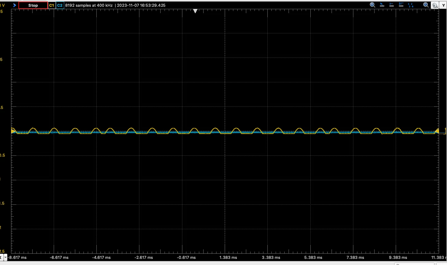

Input levels are good. Something I just noticed on the DAC output is it looks like I am only getting half (plus some bias/offset) of my output. Here I am generating a 1khz sine wave (in code, no input path enabled)

DAC: have you checked the Codec specs if the headphone output needs some minimum load?
BTW, your output is not only cut off, but the sine is also not continuous. Maybe check your sine buffer, also make sure you feed the DAC with the correct signal type, probably 2s complement with 0V as center.
ADC: I guess there is a setting to bypass the PGA, from the codec's pin naming it looks like IN1L/R can be used as standard line inputs.
