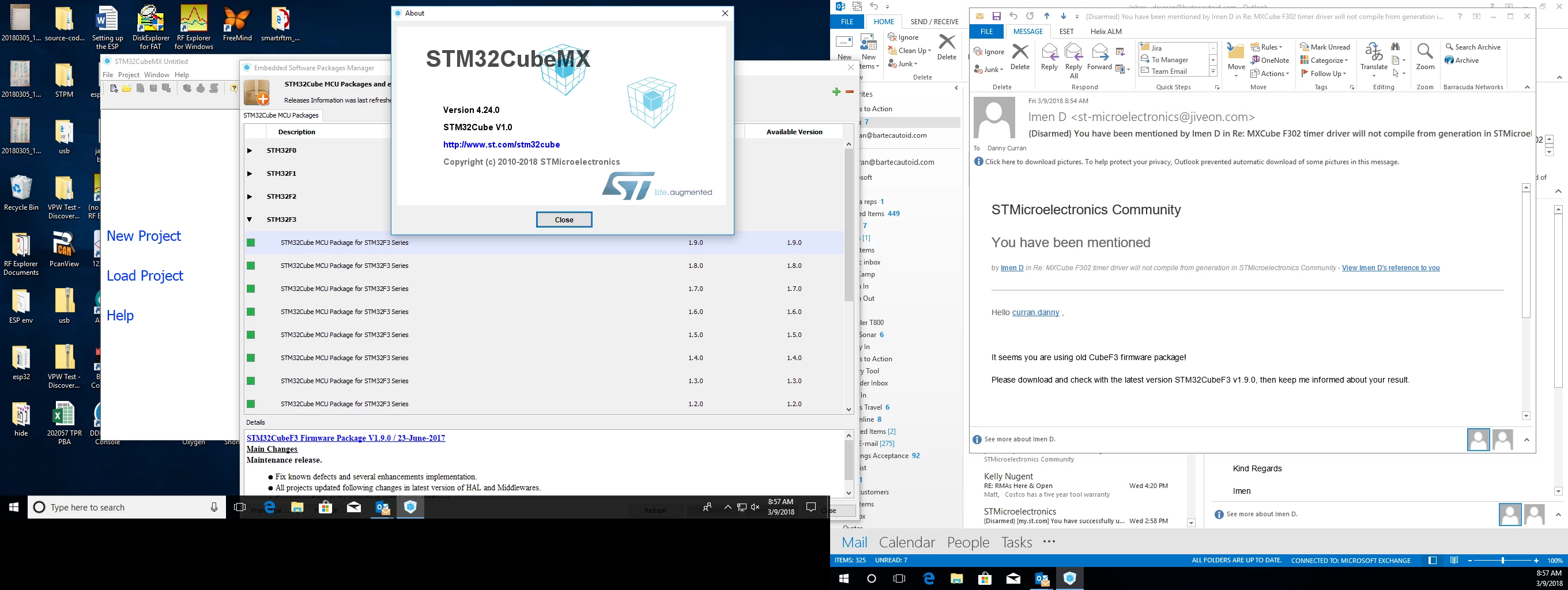

    dcurran2
    dcurran2Author
    March 9, 2018
    Posted on March 09, 2018 at 10:05
    I have just checked on Cube and its up to date
    the MxCube version is 4.24.0
    using Manage Embedded Software packages 1.9 has been downloaded etc
    TM32CubeF3 Firmware Package V1.9.0 / 23-June-2017
    Main Changes
    Maintenance release.
    • Fix known defects and several enhancements implementation.
    • All projects updated following changes in latest version of HAL and Middlewares.
    • General updates to be compliant with Linux platforms.

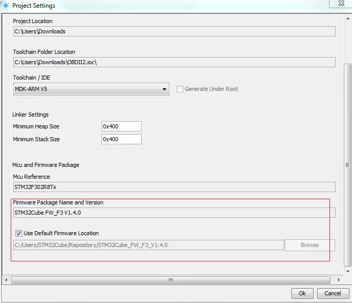

    When I open your ioc file and Project settings, I see you are using the firmware version
    STM32Cube_FW_F3_V1.4.0.
    Please check In your Project Settings menu that the firmware package version used is STM32Cube_FW_F3_V1.9.0, Otherwise, you should update the firmware location to use the latest version.

    Does this mean you cant use an old cube project with a newer version of the Firmware libraries automatically ?
    e.g. the firmware lib is not automatically updated to use the latest version. ?
     I have done as suggested and Cube produces different code
    taken from the ioc file I can now see the following
    ProjectManager.CustomerFirmwarePackage=C\:\\Users\\dcurran\\STM32Cube\\Repository\\STM32Cube_FW_F3_V1.9.0
    ProjectManager.FirmwarePackage=STM32Cube FW_F3 V1.4.0
    I can also see new *.h files
    Can I suggest to your dev team that they make the user more aware that a old firmware package is in the ioc file
    as I had all the previous versions of the F3 lib  and it wasn't until I removed all previous firmware libs that cube indicated there was an option

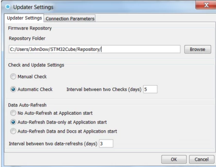

    It's recommended to use latest version of Cube firmware package and CubeMx tool as there is always enhancement and bugsfixes in the new release.
    STM32CubeMX can check if there is a
    new library package installation or updates
    for new STM32CubeMX tool version.
    For that, in the Help > Updater Settings tab, you shouldenable the Automatic check for updates.
    In the Project Tab, there isa Use Default Firmware Location
    checkbox
    (which is specified under the Menu Help > Updater settings)
    specifying
    the
    path forthe
    installed firmware packages version and
    by default, the latest available version is used for the project.
