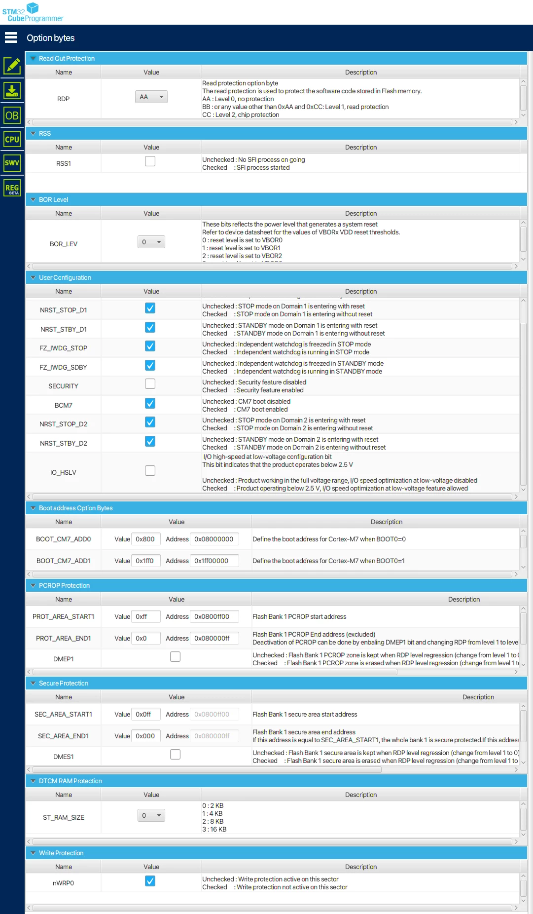

Is it possible to modify this register field using STM32CubeProgrammer?
I've tried both:
  • Writing a value using the Registers tab
  • Writing to a memory address that the field occupies
But neither work.
    1 reply
    November 30, 2021
    The BOOT_ADD0 option byte can be modified from within the option bytes editor in STM32CubeProgrammer. The "OB" icon on the left.
    Option bytes ultimately reside in non-user FLASH and need to be applied by setting OBL_LAUNCH and letting the chip reset. This is what "Apply" does in the option bytes area.
    dscdsc
    dscdscAuthor
    November 30, 2021
    That's what I thought too, but I don't see that in the option bytes section.
    December 28, 2021
    Just in case others see this, looks like your chip doesn't have a BOOT_ADD0 option byte. Is there a reason you think it should? The BOOT_CM7_ADD0 is what you want to change.
    It does appear that the H743 reference manual suggests BOOT_ADD0 exists.
    Put your chip number in your post so others don't have to guess what you're using.
