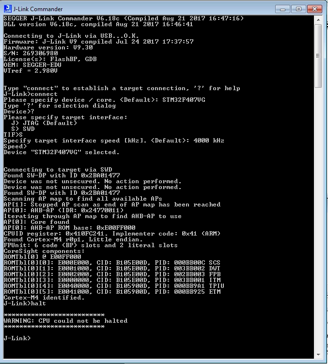

Good morning,

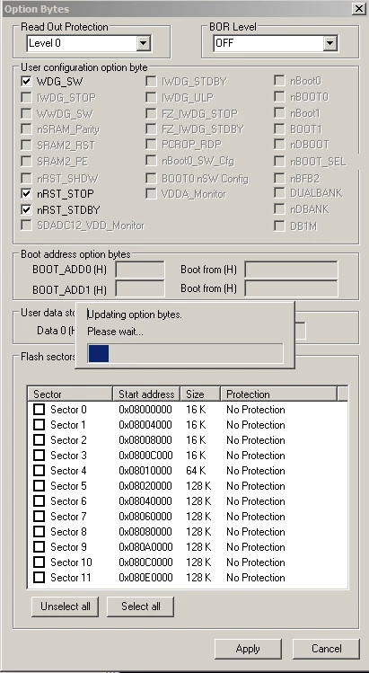

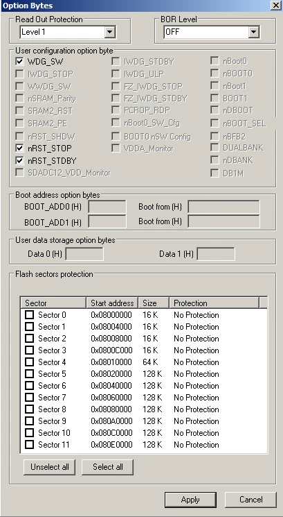

I got an issue with the ROP-Level (read out protection) and therefore the MC is locked for further flash – actions. The power supply has been interrupted during an flash – action. I assume that this is the reason why the ROP level has been set to 1.

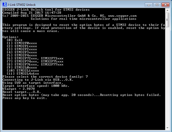

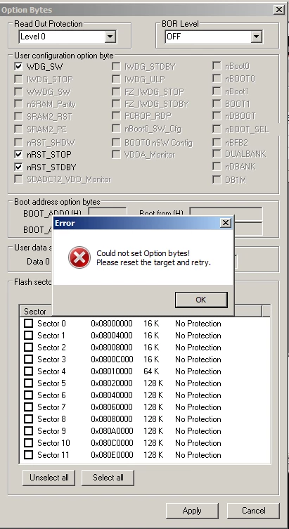

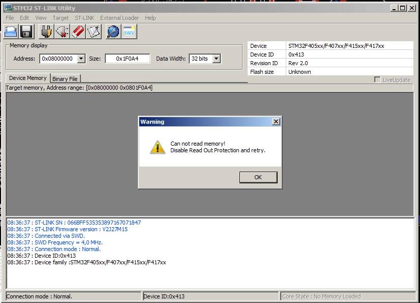

However, I checked the common sources and pages for troubleshooting / handling for that issue. I tried the ST-Link utility tool and the J-Link command line / J-Link unlock tool.
I’m not able to reset the ROP level to 0, neither with the on or the other tool.

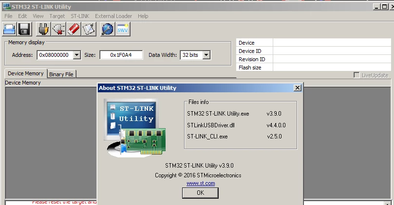

Please see the attached screenshots (two for J-Link and 5 for ST-Link).
May you can give me a few hints to fix that issue?
Kind Regards,
Kusche

    Tried a mass erase within the ST-Link tool ?
    Didn't check recently, but former versions had such a menu point.
    Or the system bootloader via the Boot0/Boot1 pin trick ?
