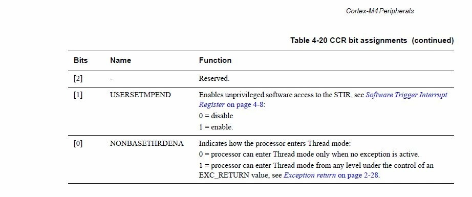

    NONBASETHRDENA bit in in Cortex Configuration and Control Register(CCR) controls the entry to thread mode from handler mode.
    Eg If this bit is 1, POPing PC from stack , can do the jump in thread mode.

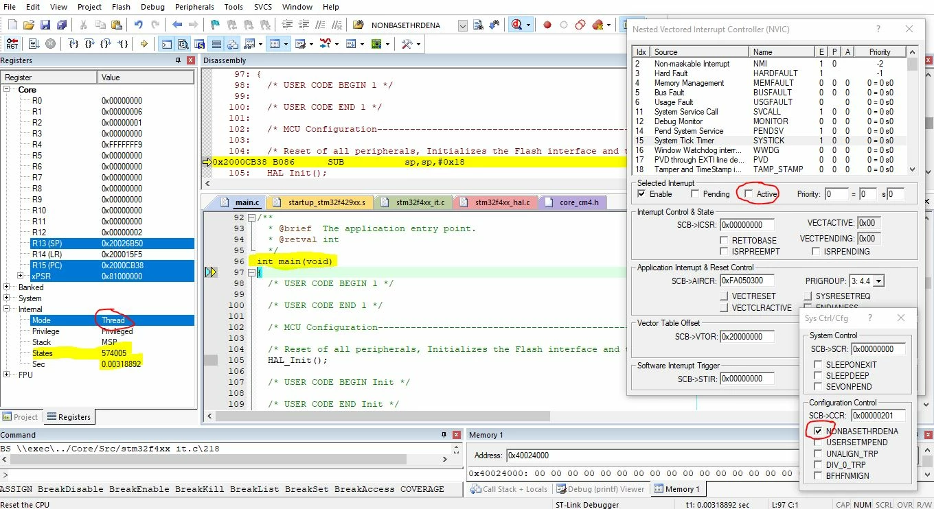

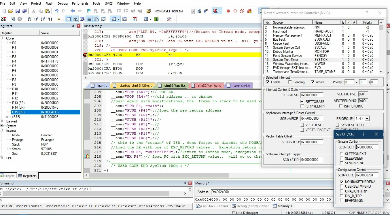

    Here is a return address substitution example and it is inside a HAL's generated systick IRQ handler.
    Warning, This example uses MSP only, for thread and handler modes. The new program has the responsibility to initialize again the stack pointer.

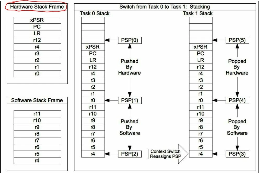

    Two words poped at beginning to expose the pushed frame these words pushed by compiler I found that was only two in this case . Strongly suggest to make a naked IRQ handler function (assembly) to have the full control of the compilation.
    Compare the two pictures to see the differences after execution of jump.

    	//SET this bit, so the processor can enter Thread mode under the control of an EXC_RETURN value (given to PC reg.)
    	SCB->CCR |= SCB_CCR_NONBASETHRDENA_Msk;// set bit 0

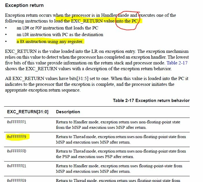

    	// this is the "jump" of ISR , dont forget to disable the NONBASETHRDENA bit when start the new program(thread mode )
    	//load the PC with one of EXC_RETURN values.. Exception return values,described in cortex Generic User Guide
    	__asm("LDR R4, =0xFFFFFFF9");//Return to Thread mode, exception return uses non-floating-point state from MSP and execution uses MSP after return.
    	__asm("BX R4");// load PC with EXC_RETURN value.. will go to thread mode, after xPSR(8th word) poped from stack

    	// take only the xPSR from stacked frame and discard the rest
    	__asm("POP {r2-r8}");// POP R0,ri,r2,r3,r12,lr,pc
    	__asm("POP {r2}");// POP xPSR	to use it
    	__asm("MSR MSP, R0");//set the new stack pointer
    	__asm("DSB");// wait for store to complete
    	__asm("ISB");// reset pipeline
    	//Make a new stack frame
    	__asm("PUSH {R2}");//xPSR
    	__asm("PUSH {R1}");// new address to go
    	__asm("PUSH {R0-R5}");// just complete the next of stack frame with "dont care" values. But if you care to return something , just modify it
    	__asm("LDR R0, =0xFFFFFFF9");//Return to Thread mode, exception return uses non-floating-point state from MSP and execution uses MSP after return.
    	__asm("BX R0");// load PC with EXC_RETURN value.. will go to thread mode, after xPSR(8th word) poped from stack
