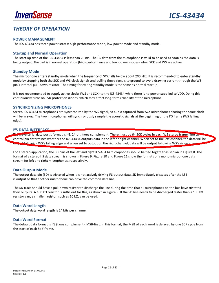

I'm doing an audio recording with the SAI interface of the STM32L4R9AI microcontroller.
I'm using DMA in circular mode and I'm getting audio data which I wrote into SD memory.
However, when I tried to open the recorded file , I hear my audio speech with a great noise .
I'm working with these parameters :
  • Sampling rate : 48K
  • Data per sample : 24 bits
  • Audio mode : Mono mode
  • Audio protocole : Free protocol
The microphone I'm using is the ICS-43434 which outputs PCM audio frame and supports I2S protocol.
Have encountered such issue before ?
What kind of checks should I do when it comes to audio recording with SAI ?
I suspect this is some CubeMX stuff so I wonder what does this exactly mean in terms of SAI registers value and how does it match the microphone's requirement:
