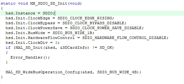

 I use STM32cube Mx to

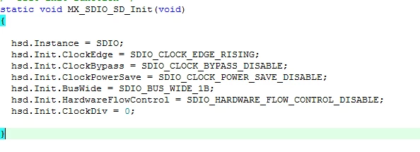

configure stm32f4 discovery with SD card 4 wire as mass storage. This is the code if I don't use FATFS :
and this is the code if I use FATFS:
version 4.19.0. Sorry for my bad English  .

    Hi
    quoc.anh
    In fact this is not a bug,when using the
    FatFs file system middleware
    ,theHAL SD initialization iscalled on theBSP_SD_Init function onbsp_driver_sd.c file.
    Please refer to this example,about how to use STM32Cube firmware with FatFs middleware component as a generic FAT file system module, in order to develop anapplication exploiting FatFs offered features with microSD drive configuration:
    STM32Cube_FW_F4_V1.0\Projects\STM32469I-Discovery\Applications\FatFs\FatFs_uSD
