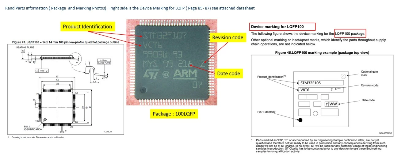

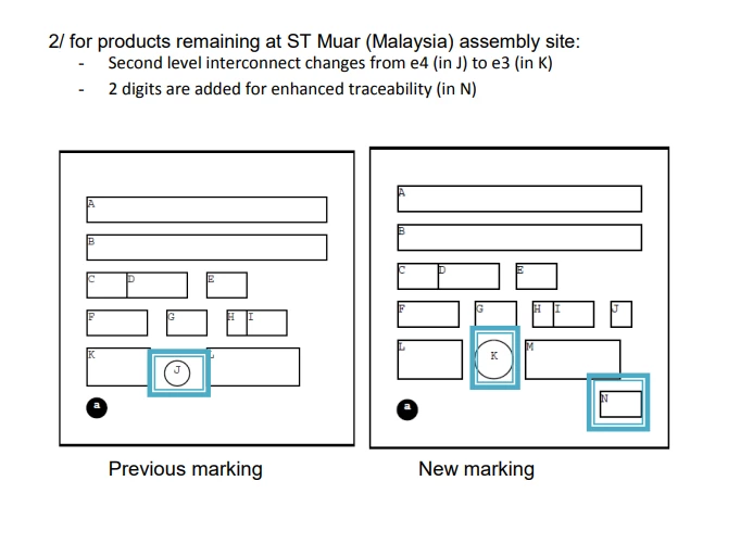

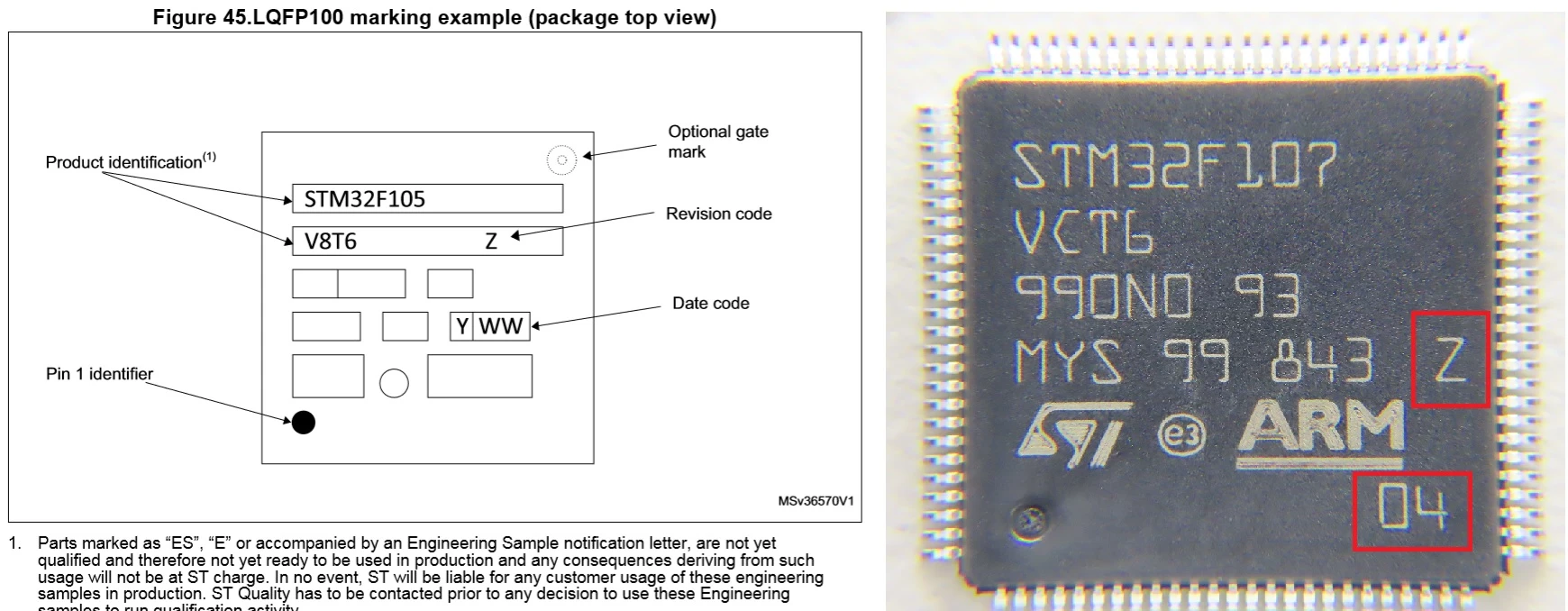

    i have the same question if theres an updated datasheet that tells that the revision code was move on line 4 from previous line 2 or pcn for device marking for LQFP 100 . Appreciate if the Technical team help us to provide some documents that supports this change

    How about a picture of the device(s) you have.
    There should be several PCN available, but it might help to narrow this down to a specific time frame and plant.
    Contemporary labeling from the reels might help further.
    Tracing is best done via your local sales office.

    please see hope ST Technical team support this

    The product looks new and is marked consistently with the packaging.​ Work with your distributor. Or open a Support Case from the main support page.
