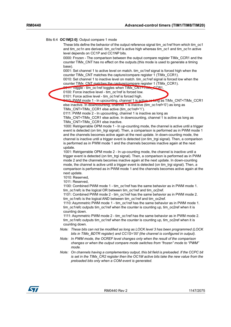

Is there a way to set timer CH1 pin (PA5) to LOW from code?
  • February 11, 2021
  • 3 replies
  • 1158 views
I have configured TIM2 to set CH1 to Force Active if x Pulses are reached. That's working fine.
Is there are a way to set it to LOW again from code (main loop)?
This seems not to work:
HAL_GPIO_WritePin(GPIOA, GPIO_PIN_5, GPIO_PIN_RESET);

Uwe Bonnes
Chief
February 11, 2021
Lopp in the reference manual for foirced output mode.

waclawek.jan
February 11, 2021
Reference Manual.
AFied.1
AFied.1Author
February 11, 2021
Nice, that's helpful. Thanks a lot!​
Uwe Bonnes
Chief
February 11, 2021
If nothing elpse help, consider also to switch to and back toGPIO alternate function to output with the right ODR value.
