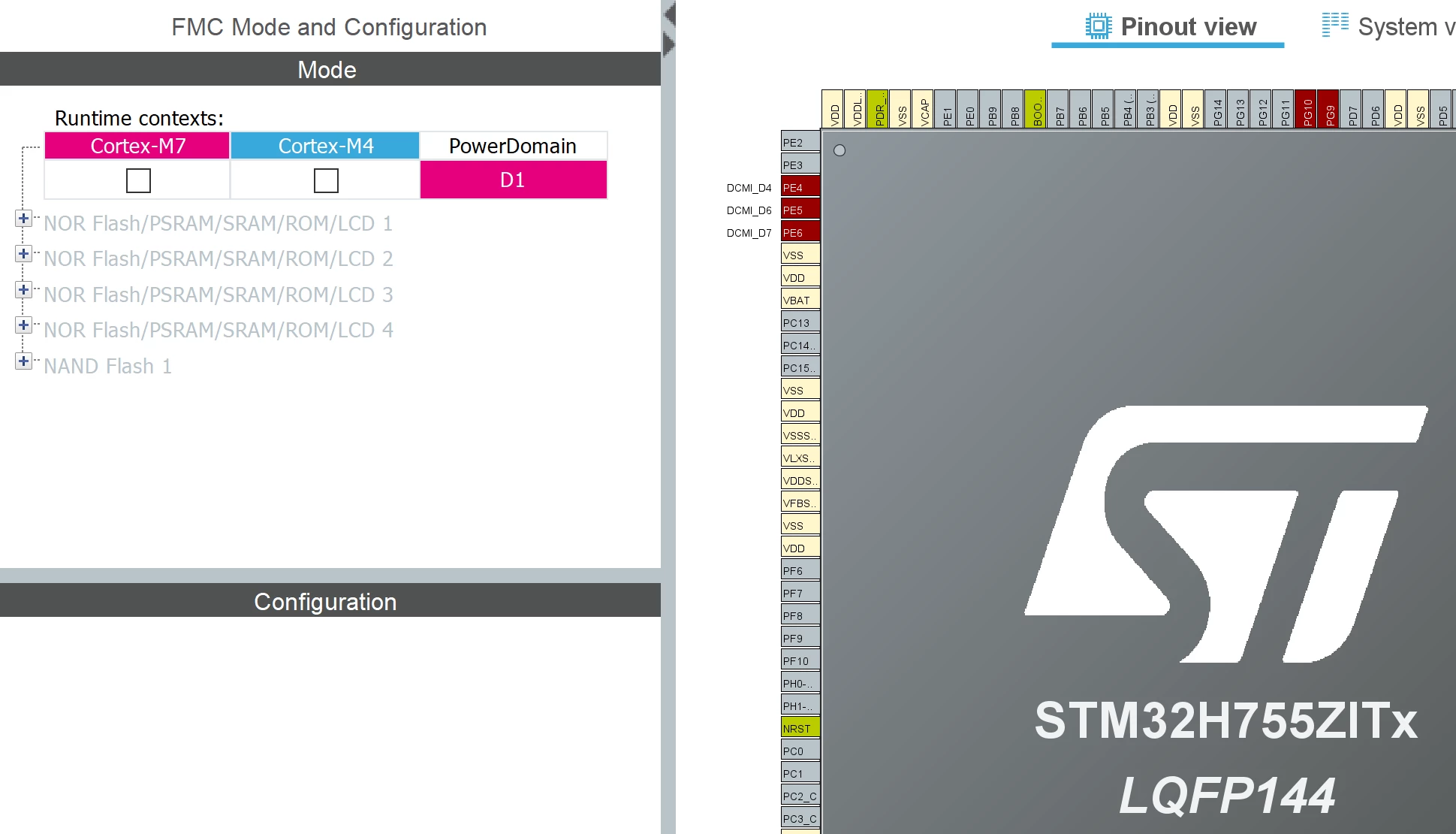

Is it not possible to connect a SDRAM to the STM32H755ZI microcontroller?
  • March 23, 2022
  • 1557 views
With other MCUs I get an additional SDRAM 1 and SDRAM 2 option. Or is it only not available to configure in CubeMX and I should code it myself?
0693W00000KdhhGQAR.pngThanks in advance.
2 replies
March 23, 2022
The LQFP144 package lacks necessary pins for SDRAM and thus is unavailable for selection in CubeMX.

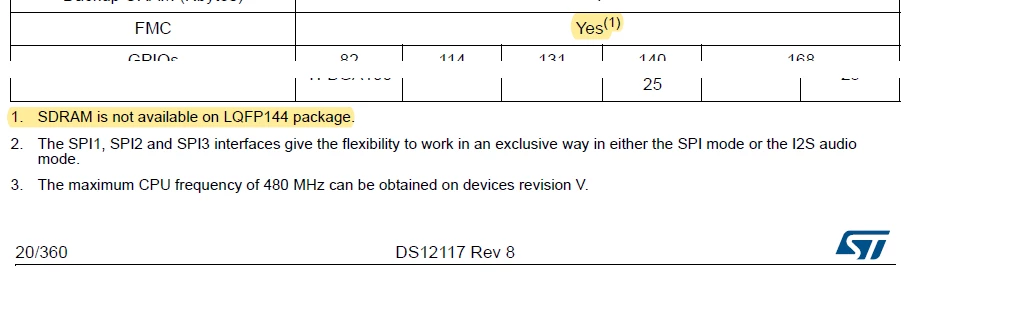

March 23, 2022
Unfortunately, SDRAM feature is not available on LQFP144 packages in STM32H7xx products.
The update of STM32H755 datasheet is ongoing and a fix will be available like done in the latest version of STM32H753 datasheet (DS12117 Rev 8) / Table 2.
