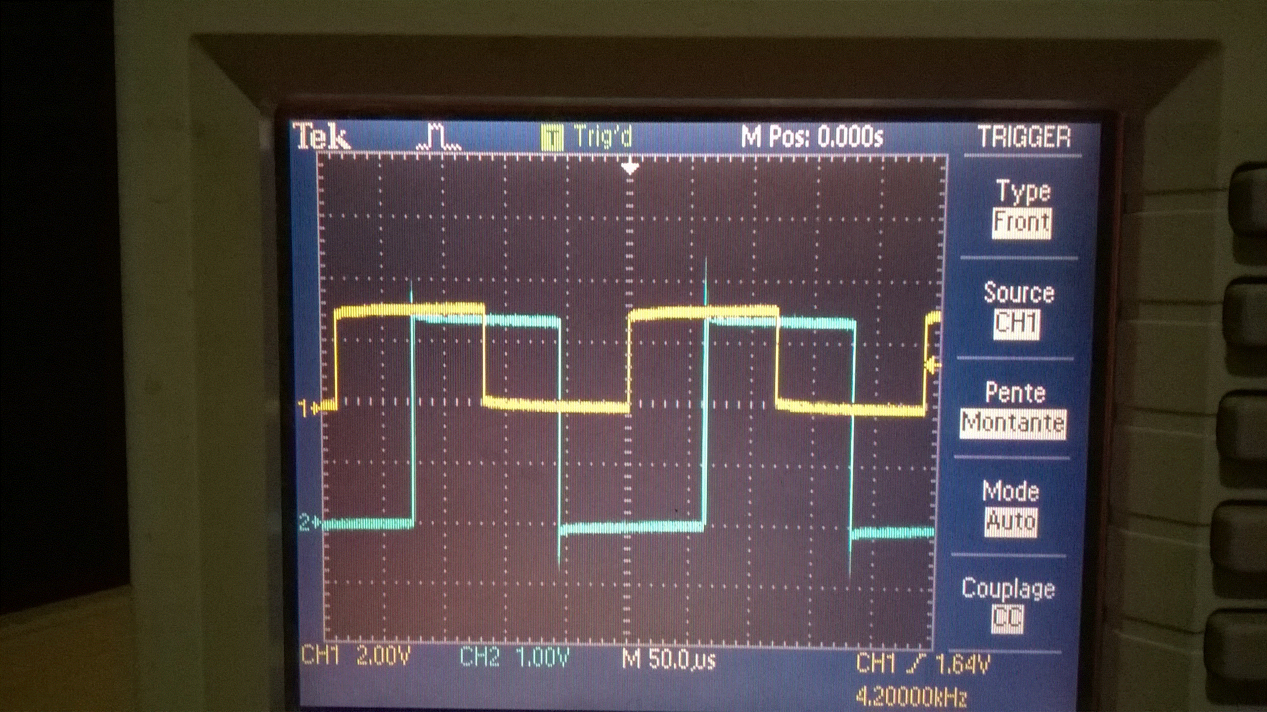

I use a nucleo stm32f401RC Evaluation Board for the regulation of a boost converter and I need to generate the interruption on the ON half-signal of PWM and I need also synchronize the conversion of 3 channel of the  adc using DMA with this interruption, to do this I set the timer 3 on the way up / down and I activated the global interruption of this timer.
My first problem is that the interrupt generated in the overflow and underflow of the timer, I want an interrupt only on the overflow.
Second problem, I generate a  event output of timer 3 for connecting it with the input trigger of the DMA and I got the same problem, the conversion is done on the overflow and underflow.

void TIM3_IRQHandler(void)
  /* USER CODE BEGIN TIM3_IRQn 0 */
  /* USER CODE END TIM3_IRQn 0 */
  HAL_TIM_IRQHandler(&htim3);
  /* USER CODE BEGIN TIM3_IRQn 1 */
  HAL_GPIO_TogglePin(GPIOA,GPIO_PIN_8);
    TIM4->CCR1=5000;//duty_reg;
  /* USER CODE END TIM3_IRQn 1 */
in attachement  a screenshot  of the PWM and GPIO togled in the IRQ handler
Any help would be much appreciated!

    Hi bou.abdel
    I suggest you refer to the
    http://www.st.com/content/ccc/resource/technical/document/application_note/group0/91/01/84/3f/7c/67/41/3f/DM00236305/files/DM00236305.pdf/jcr:content/translations/en.DM00236305.pdf
    (General-purpose timer cookbook) and its associated firmware (
    http://www.st.com/content/st_com/en/products/embedded-software/mcus-embedded-software/stm32-embedded-software/stm32cube-expansion-software/x-cube-timcooker.html
    ). It contains some examples that may be helpful for you, mainly the ones using DMA.
