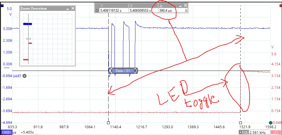

Hi @Martin HUBIK​
Thanks for getting back, by trial and error method, I've reached this point a week ago(I know someone is working on the question, but not sure how to update them. sorry about that), there is still some bugs to sort out.
Let me start with your example, all good and every thing works as you mentioned when you send data byte by byte(aprox 278us delay between bytes), but the problem occurs when send continues bytes(long string). 1st the current shouts up 2nd radio stops. beauty is the LPUART will be still receive bytes(FOR the above example I even received a \r** STOP ADVERTISING **\r\n msg).
Delay between Byte and LED toggle in BLE_p2pServer_LPUART_STOP2 project
0693W00000GZfmyQAD.pngFor 8 bytesBLE_p2pServer_LPUART_STOP2 project with delay between each toggle ~85us
0693W00000GZfpTQAT.png***What I was trying since this post***

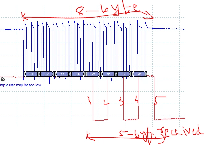

I tried changing the interrupt priority for LPUART from 0 to 1/6/15 with al this different priorities things work properly *No current shout out, *Radio Connection works and UART still work with the same byte by byte input. If I send a string of size more than 4 it will miss two bytes and catch 3rd byte.
Lets say I send 0x01 0x02 0x03 0x04 0x05 0x06 0x07 0x08 0x09 0x10 for 5 times so total 50 bytes it receives 03-05-07-09-10-03-05-07-08-09-10-03-04-05-06-09-10-03-05-07 around 22 bytes. without affecting CM4/CM0 usual routine.
Than I tried enabling FIFO the performance improved, There is no packet drop for 1st 8-bytes also, As long as I send 8-byte string with small delay between them every thing works well. If the string length is more than 8 bytes the a byte drop again.
For 0x01 0x02 0x03 0x04 0x05 0x06 0x07 0x08-------> x5times ****ALL GOOD AND received 40 byte****

For 0x01 0x02 0x03 0x04 0x05 0x06 0x07 0x08 0x09 0x10-------> x5times ***PACKET DROP OBSERVED***

So currently I'm at this point, With all your settings/**/changing LPUART priority/**/Not using DMA for TX/**/ above are my observation.
What dose LL_EXTI_EnableIT_0_31(LL_EXTI_LINE_25); actually means. From where have you got this reference.
Why is this packet drop happening?
Can you suggest me any next step...

Martin HUBIK
December 13, 2021
Hello SPalr.1,
all peripherals that have the ability to wake-up MCU from STOP mode must have the wake-up signal routed to EXTI. When the wake-up signal is enabled in EXTI it will trigger wake-up from STOP by enabling the internal LDO and starting the internal clock. In case of LPUART this signal is LPUART1 wakeup which is routed to EXTI_25. Once the MCU is woken up, it start to execute the LPUART ISR.
The FW architecture of low power modes with our BLE examples is such, that CM4 executes STOP mode entry and stop mode exit routines in critical section (all interrupts disabled). After wake-up the MCU doesn't jump to ISR directly but executes some critical code inside Stop mode exit routine.
More info on the architecture can be found in
AN5289 - Building wireless applications with STM32WB Series microcontrollers
Figure 6. Algorithm to enter Stop mode on CPU1
One of the things done in Stop mode exit routine is starting HSE oscillators which takes about 250us. This is enough to create overrun condition on LPUART RX when characters are send back to back. At Baud rate @115200 the character length is approximately 86us.
I modified the example so that it uses the internal RX FIFO, which can buffer up to 8 characters. In the LPUART RX callback (ISR context) a task is set (background context) which pus the received characters in a queue and sets up another LPURT reception. LPUART RX callback sets also second task (background context) which process the incoming data and echoes them back on LPUART TX once a New line character is found. I also configured a few GPIO debug signals to verify the timing with logic analyzer. Can you please test the code and let me know if you see any issue with it?
Best regards,
Martin
SPalr.1
SPalr.1Author
December 23, 2021
Hi @Martin HUBIK​ ,
Thanks for your time on investigating and coming up with a wise solution to deploy
LPUART with BLE applications.
In mean time I’ve come up with an alternative solution too, with no DMA, no EXTI_25, enabling FIFO and lowering the UART ISR priority to 6.
This was the same setup which I was working for a while and had issue with 1/2 byte dropping for every 8 bytes.
By the time you are working for the above solution I twining around many possibilities to make it happen and one attempt worked. JUST after enabling Single Sample (LPUART Advance Parameters, SDK hlpuart1.Init.OneBitSampling = UART_ONE_BIT_SAMPLE_ENABLE; ) things seams to work fine. No more byte dropping.
But still it was confusing what “UART_ONE_BIT_SAMPLE_ENABLE�? have done to solving byte dropping.
I’ve attached my sample project for your reference.
If you have any idea on what one bit sampling might have done to solving the uart issue, please share it.
