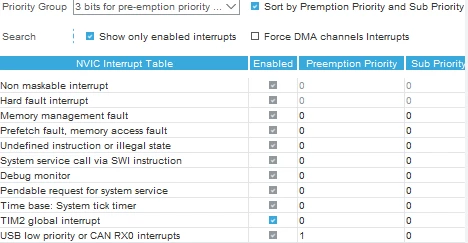

hello, i have a input capture who lost edge when i plug USB.
when the USB cable is not plug or unpluged works perfectly.
i have a toggle led in the capture callback.
when i plug the frequency of the led is unstable.
when i unlug cable, toggle frequency become stable again.
i don't understand because the Priority is
have you an idea?
i will search...
thanks

What else is the mcu doing? ​it might very well be that somewhere you do too much work in ISR which makes you miss input capture interrupts If those happens very frequently.
Edit: hal_drivers does make it very easy to code everything in ISR context without even realising it.​

Do you have other callbacks active? Those would be the ones that most likely make you skip interrupts.
I don't have enought knowledge about how the USB stack works to say anything about how much of processor time it will take, since it could be that alone which makes you miss interrupts

Check Overcapture flag. That tells you if you'r program wasn't fast enought to readout capture register. Make sure that edges coming with reasonable delay between them. There is some minimum time you need to read capture register and depends on method how you are reading it. Other interrupts with higher priority can delay your timer ISR. Consider use DMA to read captures... it's the fastest way... but of course another DMA with higher priority can block you too...

okay but my signal is at 49Hertz..... ^^ is very slow.
TIMER2 channel 1, maybe is used by USB.
TIMER2 channel 2 is better but not good.
i can't be more quickly than read a register in ISR and i think if i delete all the code in the callback.
it's the same,just kept a toggle led. it's visual.
