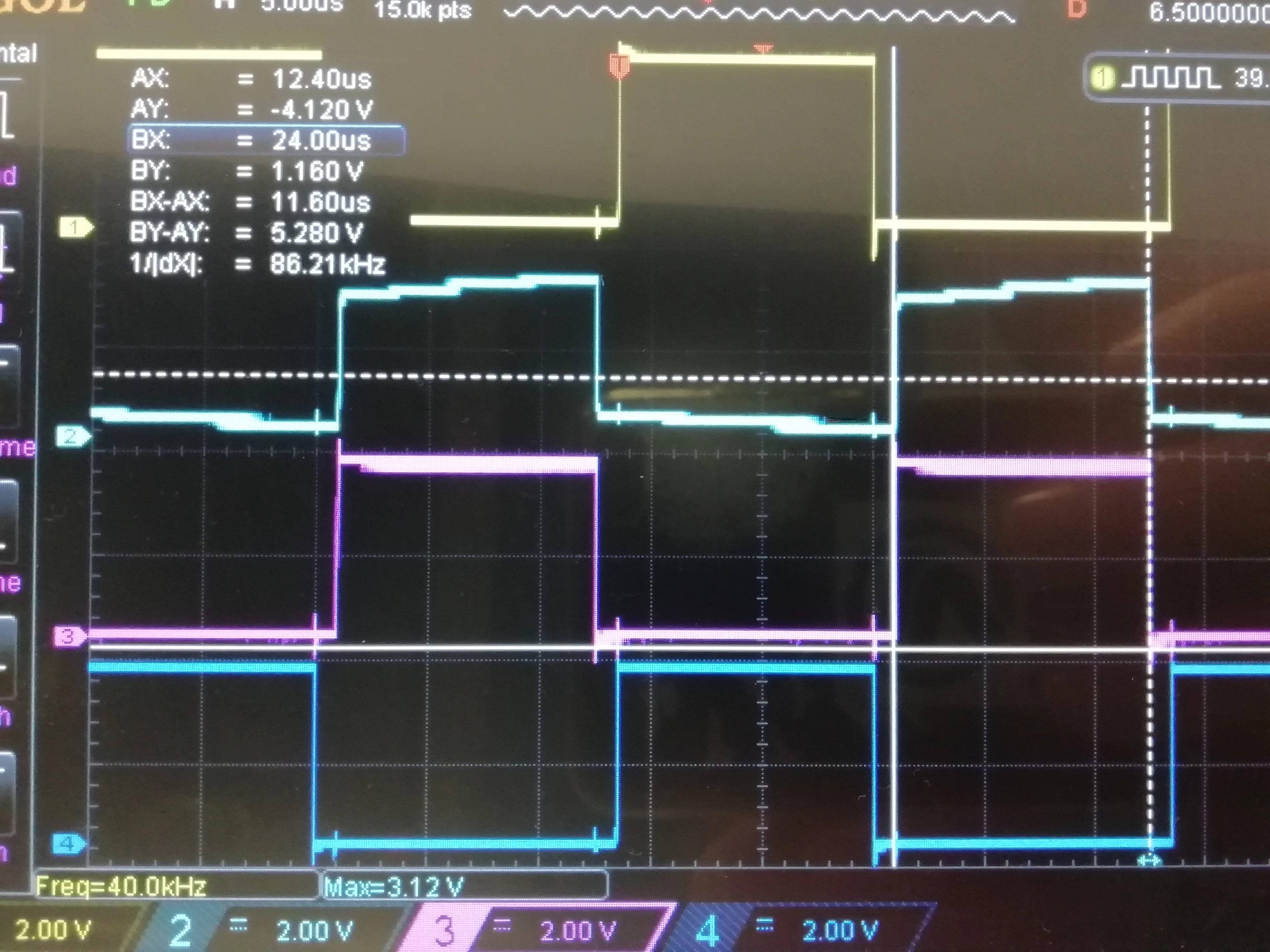

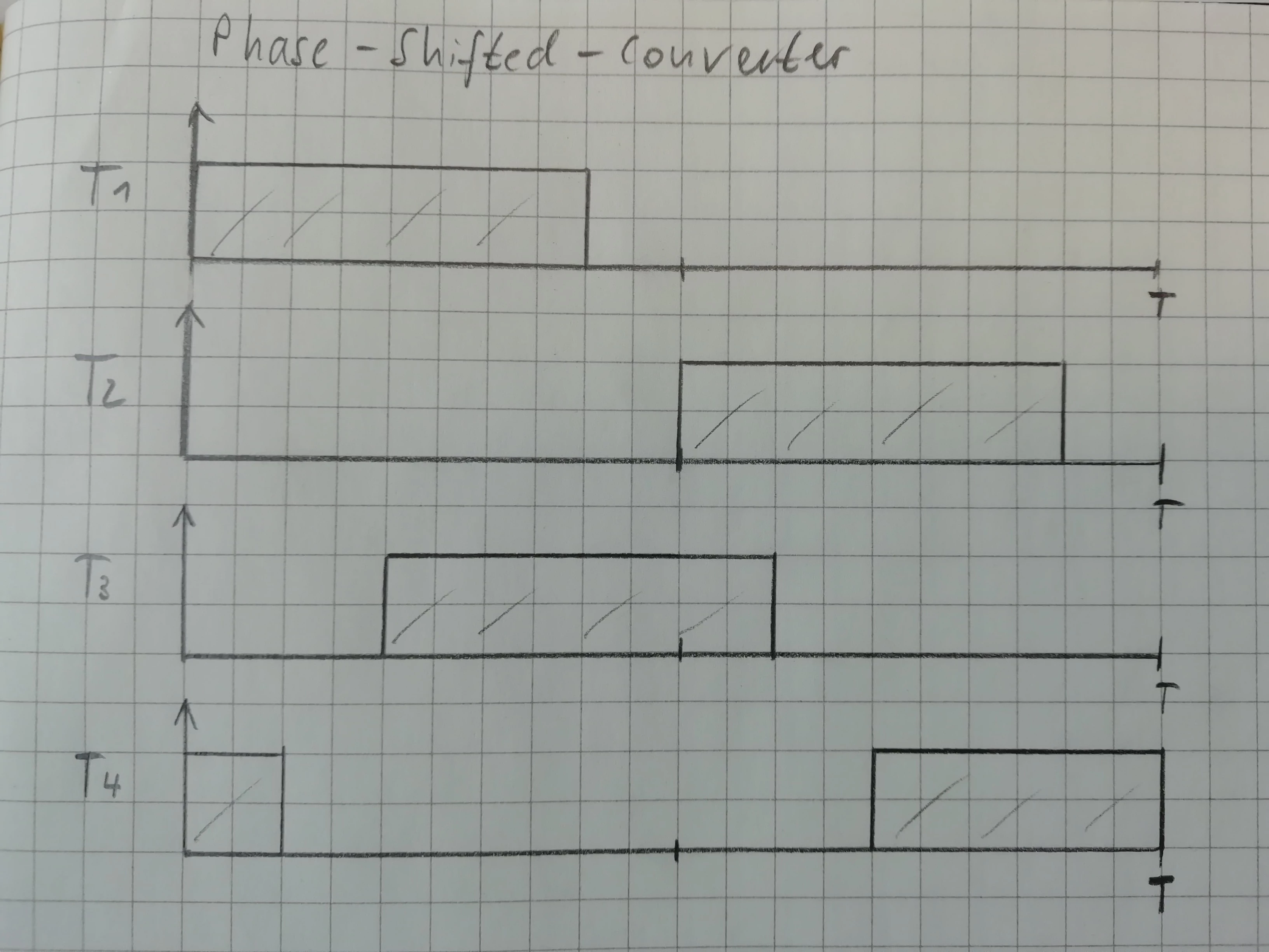

Iam trying to implement a phase shifted 4 channel PWM on STM32F302R8 .The PWM signals should look like the first picture. I use CH and CHN complementary PWM generation with deadtime insertion. PWM mode ist asymmetric PWM Mode 1 for both channels.. But I cant create an overlap of channel 1 and 3. Turn on time of all pwms should be equal I just want to adjust the phase shift. Right now PWM looks like the second picture. I use the following compare values:
 TIM1->CCR1 = 0
 TIM1->CCR2 = 800
 TIM1->CCR3 = 500
 TIM1->CCR4 = 300

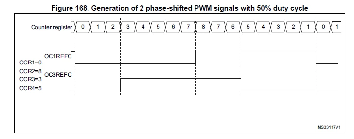

    Iam not sure what you mean with cutting them down to 2. I always thought I could handle CH1 and CH1N asymmetrical and a second channel CH2 and CH2N asymmetrical. I refer to p. 488 of the RM0365 Reference manual where the attached picture is from.

    Now its a bit clearer to me. But still I think it would be sufficient to have CH1 and CH3 phase shifted. I only need to adjust this shifting. CH1N and CH3N will result. I only use TIM1. The registers of TIM1 are in the attached file.
    Still I am in doubt about this part in p488 of reference manual...
    "Figure 168 represents an example of signals that can be generated using Asymmetric PWM
    mode (channels 1 to 4 are configured in Asymmetric PWM mode 1). Together with the
    deadtime generator, this allows a full-bridge phase-shifted DC to DC converter to be
    controlled".
    So do they recommend to use 2 complementary pwm with dead time insertion or 4 independent channels in asymmetric PWM mode 1 ?
    Thanks again for replying!
    MK

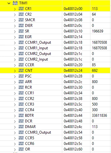

    waclawek.jan
    January 29, 2019
    The asymmetric (and combined) modes are afterthought to overcome the limitation I've been talking about previously, i.e. that one edge of the channel pulse is always aligned to the moment of overflow (update), So, these new modes combine two adjacent channels (1&2 and 3&4) to produce one output waveform.
    The register settings you've sent are not related to the oscilloscope picture you provided above, are they?
    There is no point in setting 0 and 800 to CRR if ARR=800. This results in constant level output. Use numbers in between.
