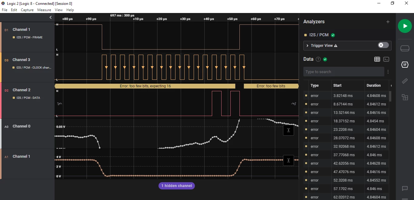

MYadw.2
MYadw.2Author
October 26, 2022
This is what I am receiving on the logic analyzer and could not relate it to waveform of the stm32f746 reference manual and I am not understanding how WS is behaving
waclawek.jan
October 26, 2022
So, you don't see any data doubling in the signal? Then the problem can be localized to the receiver.
Which STM32 is the receiver?
How exactly does the problem manifest itself?
Do you use DMA? Read out and check/post content of SPI/I2S and DMA registers content.

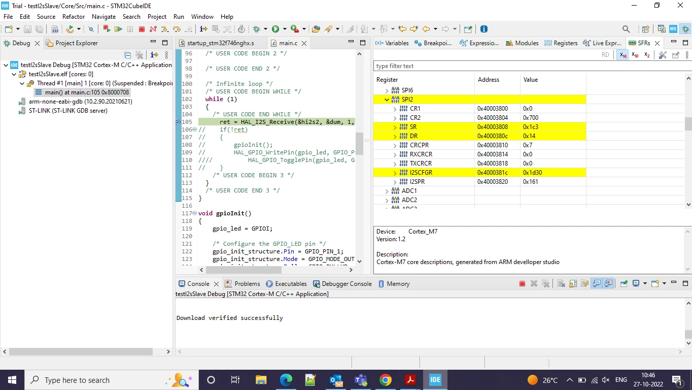

MYadw.2
MYadw.2Author
October 27, 2022
stm32f746 discovery board as my receiver.
No I am not using DMA its just polling method.
QSHAO.1
October 27, 2022
I think you may check status registers of I2S for issue analysis, like OVR, UDR...
waclawek.jan
October 27, 2022
OK so what does "but the received data is doubled" mean exactly and how do you detect that?
