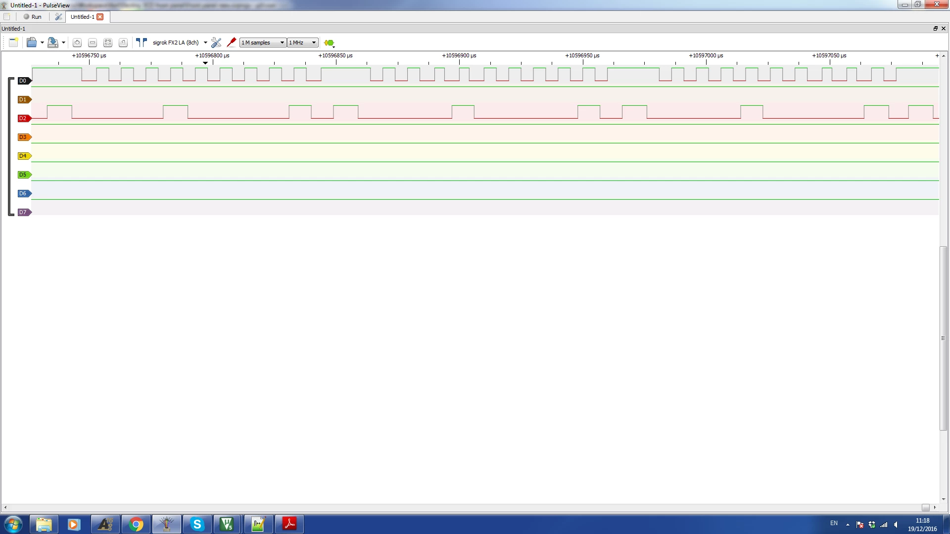

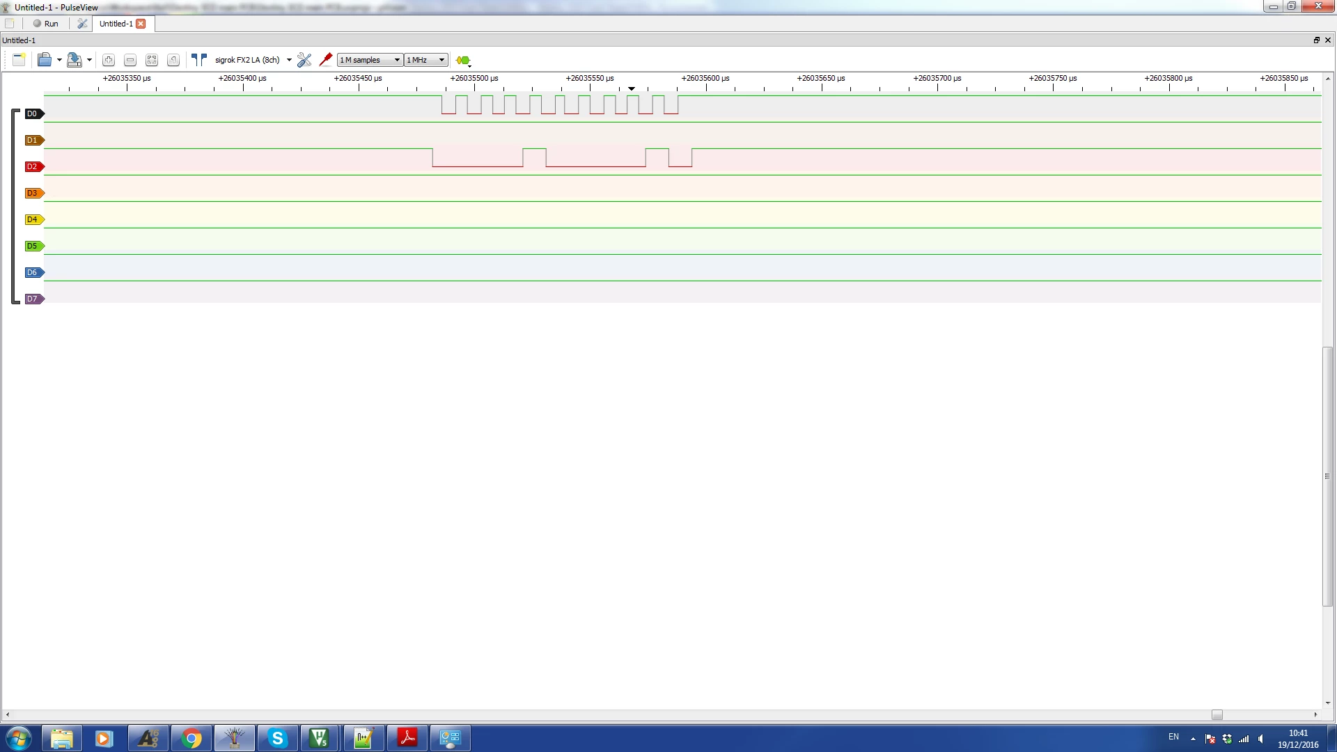

    waclawek.jan
    December 20, 2016
    Posted on December 20, 2016 at 14:22
    Receiver does not work.
    Make sure your connections are OK. Read back the GPIO registers in a debugger and verify their content is what you intended.
    [EDIT]
    I2C_CR2:
    SADD[7:1]: Slave address bit 7:1 (master mode)
    In 7-bit addressing mode (ADD10 = 0):
    These bits should be written with the 7-bit slave address to be sent
    I2C_OAR1:
    Bits 7:1 OA1[7:1]: Interface address
    Bits 7:1 of address
    Well, the latter is just another incarnation of the 'I don't understand the 7-bit address from I2C specification'. OA1 should contain the 7-bit address, ergo, drop the shift in
     I2C1->OAR1 |= (0x10<<1); // set own address
    PS.
    ast8346
    ast8346Author
    December 20, 2016
    Posted on December 20, 2016 at 15:48
    Right, so the address value has to be in the range between 0x08 and 0x77
    Also, the I2C_write function should have address shifted to the left once as well as the bit 0 has to do with 10-bit interface
    I2C1->CR2 = I2C_CR2_RELOAD | (uint32_t) (1 << 16) | (uint32_t) (address << 1);
    I have changed that, but my code still does not work
    waclawek.jan
    December 20, 2016
    Posted on December 20, 2016 at 16:53
    The address both in OAR and CR2 has the same structure, so either shift both (treating them as 7-bit address as per I2C spec) or none (treating them as the 'customary' 8-bit address).
    If you have both shifted, then again, double-check the connections and the macros you've used in the slave code.
