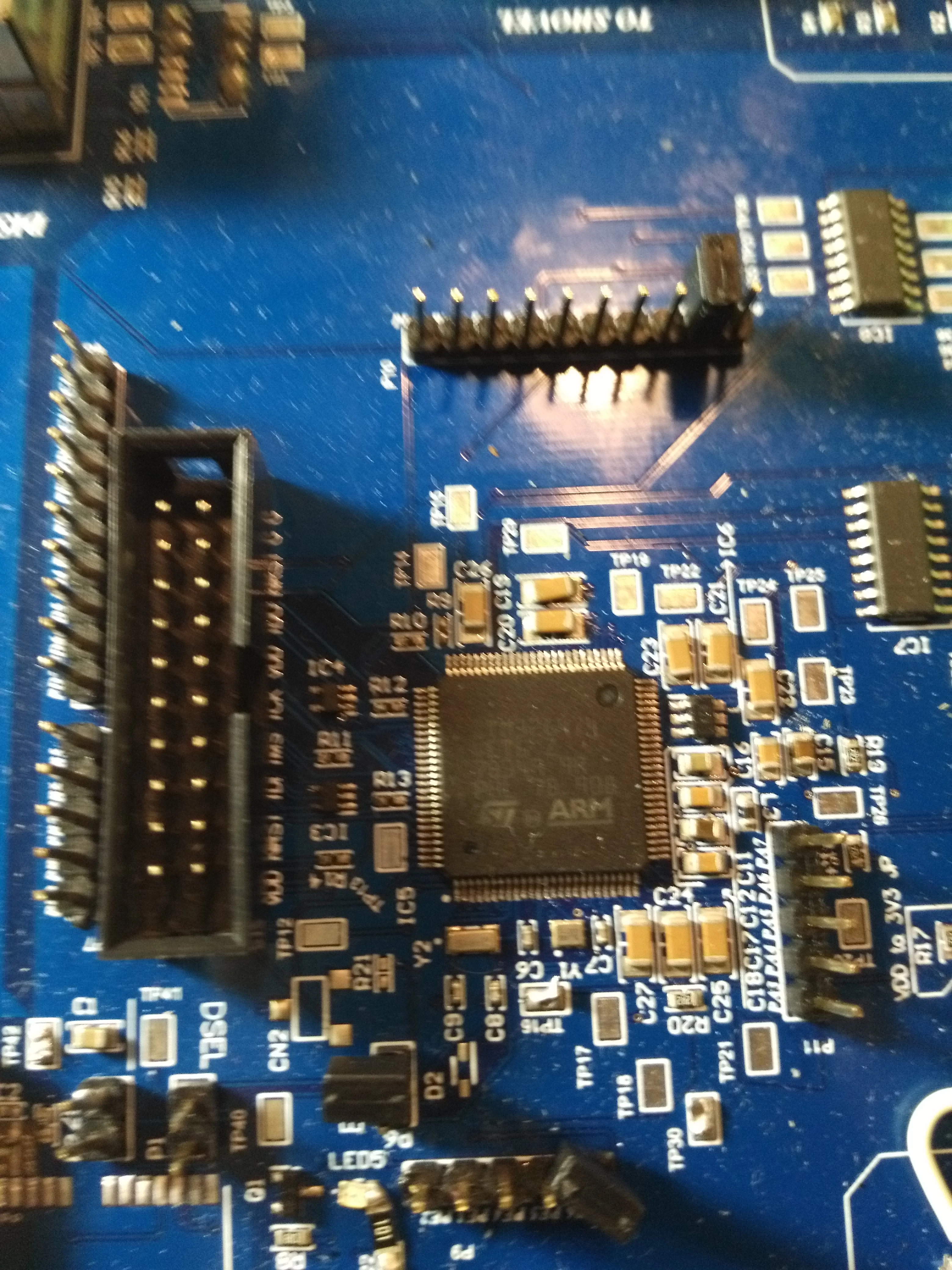

A beginner's question; How to program the 32G4, is it through the UART and if so which terminals to use?

Thanks. Still trying to figure it out. Here is a pic, I think it is the 2-row connector to the left of the micro.0690X00000Bug4GQAR.jpg
Tesla DeLorean
Guru
December 16, 2019
The connector and silk-screen suggest it is a 20-pin JTAG header, would connect to an ST-LINK/V2 or J-LINK type pod.

sorry, but what is ST-LINK/V2 or j-LINK
KDIAS.2340
December 18, 2019
How to find out if it is ST-LINK or J-LINK?
Tesla DeLorean
Guru
December 18, 2019
Either, should I Google this stuff for you?
It is a header you'd plug the aforementioned debug pods into.
Perhaps you could refer to the schematic for your board, of docs from its manufacturer.​
