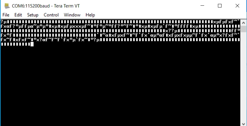

I want to implement IAP program using UART6 on stm32f205.
  • October 12, 2022
  • 1938 views
I am using IAP program of stm32f207 for the same, but it is not working. Please suggest me for the implementation.

I have used this example, but it is not working properly in my case.

while using this example it is printing garbage value, don't know why may be due to clock, we are using 12MHz external clock, can you suggest me what to do??

Make sure the PLL settings and HSE_VALUE define reflect the clock speed you're using.​
