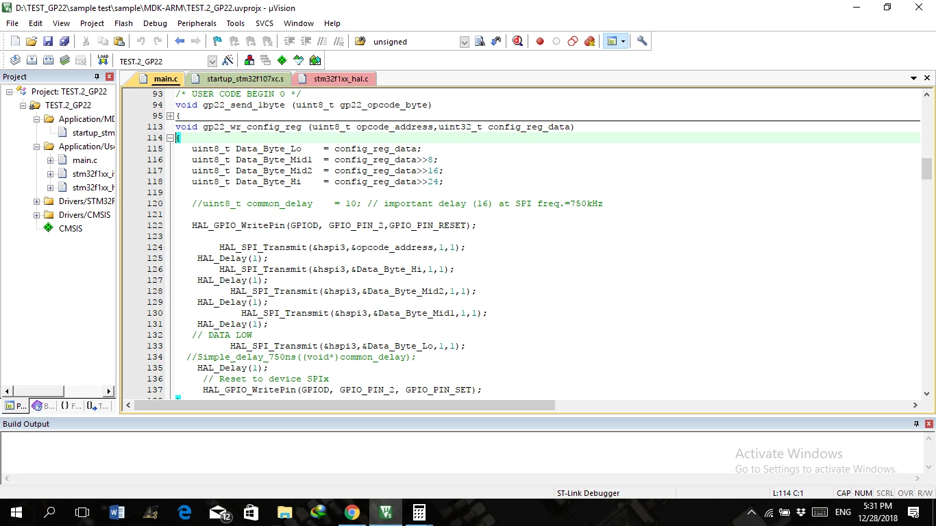

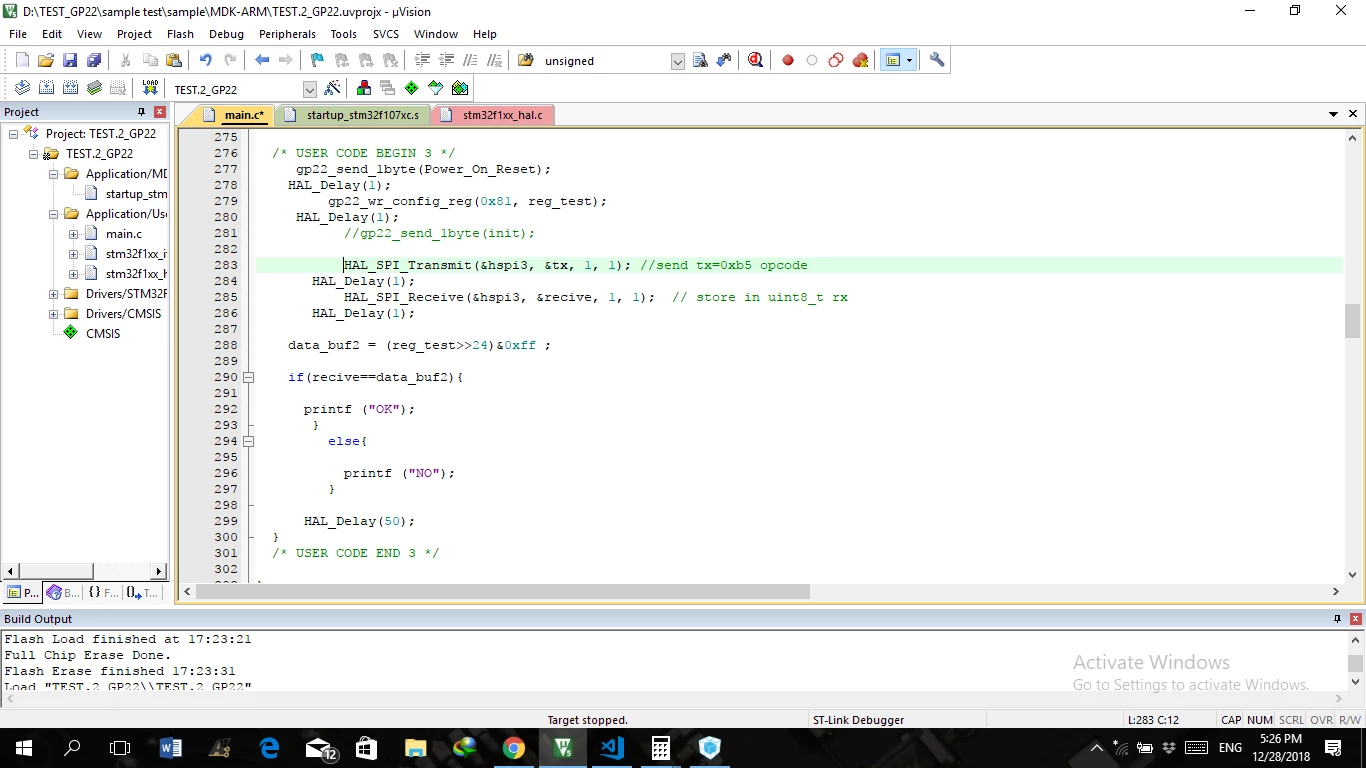

I'm trying to communicate between the STM32F107VC (master mode) and a TDC GP22 slave chip but came across this issue:I'm expecting to read 0x12 but i always get 0xFF, plese help me my email: amiryal.me@gmail.com

		 gp22_send_1byte(Power_On_Reset);
 HAL_Delay(1);
 gp22_wr_config_reg(0x81, reg_test);
		 HAL_Delay(1);
 //gp22_send_1byte(init);
 HAL_SPI_Transmit(&hspi3, &tx, 1, 1); //send tx=0xb5 opcode
 HAL_Delay(1);
		 HAL_SPI_Receive(&hspi3, &recive, 1, 1); // store in uint8_t rx
			 HAL_Delay(1);
		data_buf2 = (reg_test>>24)&0xff ;
		if(recive==data_buf2){
			printf ("OK");
 else{
					 printf ("NO");
 HAL_Delay(50);
void gp22_wr_config_reg (uint8_t opcode_address,uint32_t config_reg_data)
 uint8_t Data_Byte_Lo = config_reg_data;
 uint8_t Data_Byte_Mid1 = config_reg_data>>8;
 uint8_t Data_Byte_Mid2 = config_reg_data>>16;
 uint8_t Data_Byte_Hi = config_reg_data>>24;
 //uint8_t common_delay = 10; // important delay (16) at SPI freq.=750kHz
 HAL_GPIO_WritePin(GPIOD, GPIO_PIN_2,GPIO_PIN_RESET);
			 HAL_SPI_Transmit(&hspi3,&opcode_address,1,1);
		HAL_Delay(1);
			 HAL_SPI_Transmit(&hspi3,&Data_Byte_Hi,1,1);
 HAL_Delay(1);
					HAL_SPI_Transmit(&hspi3,&Data_Byte_Mid2,1,1);
 HAL_Delay(1);
						HAL_SPI_Transmit(&hspi3,&Data_Byte_Mid1,1,1);
 HAL_Delay(1);
 // DATA LOW
					HAL_SPI_Transmit(&hspi3,&Data_Byte_Lo,1,1);
 //Simple_delay_750ns((void*)common_delay);
		HAL_Delay(1);
 // Reset to device SPIx
 HAL_GPIO_WritePin(GPIOD, GPIO_PIN_2, GPIO_PIN_SET);

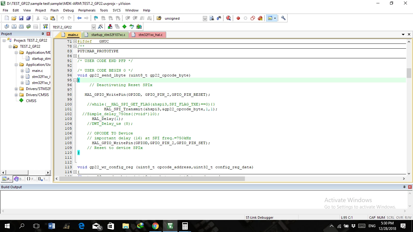

void gp22_send_1byte (uint8_t gp22_opcode_byte)
 // Deactivating Reset SPIx
		//while(__HAL_SPI_GET_FLAG(&hspi3,SPI_FLAG_TXE)==0){}
			 HAL_SPI_Transmit(&hspi3,&gp22_opcode_byte,1,1);
 //Simple_delay_750ns((void*)10);
			HAL_Delay(1);
	 //DWT_Delay_us (8);
 // OPCODE TO Device
 HAL_GPIO_WritePin(GPIOD,GPIO_PIN_2,GPIO_PIN_SET);

I'm expecting to read 0x12 but i always get 0xFF,I write to register 1 the value 0x12345678 And when i do the test by sending the opcode 0xB5, i should receive the highest 8 bits from that value (0x12).and i any thing write in reg1 i always recivce 0xff,i once replace my tdc_gp22 with a new one, but dont corrected,Where is my mistake? im very confused and tired,plese help me

Review the signal with a scope or logic analyzer. Understand if you're battling an issue on the STM32 or GP22
I suspect you need a delay after raising the chip select. I would use the TransmitReceive form to pull back data. Data sheet doesn't indicate the need for waits between single bytes.
S.Ma
Principal
December 28, 2018
Use an oscilloscope to look at NSS, MISO, MOSI and SCK and compare with datasheets.
