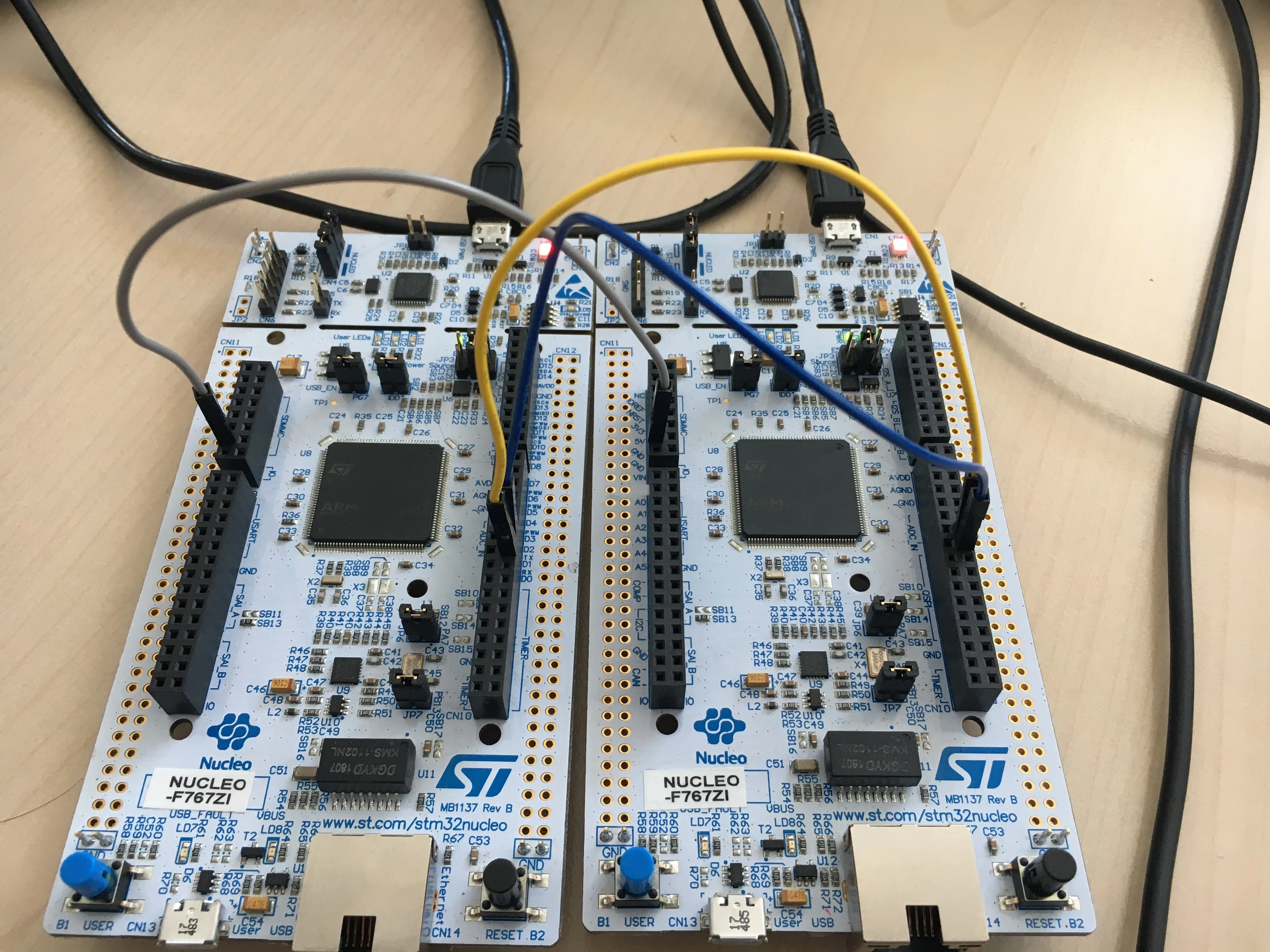

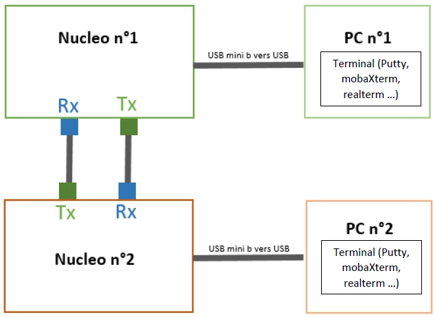

I'm a beginner and i'd like to start with STM32, and use uart protocol to communicate between two F767ZI cards (sorry for my english)... ^^ I use STMCubeIDE, downloaded stlink009. I saw lot examples on other stm32 without result when i code something
  • July 9, 2020
  • 1787 views
Moreover i understood that printf function is so complicated to be used.

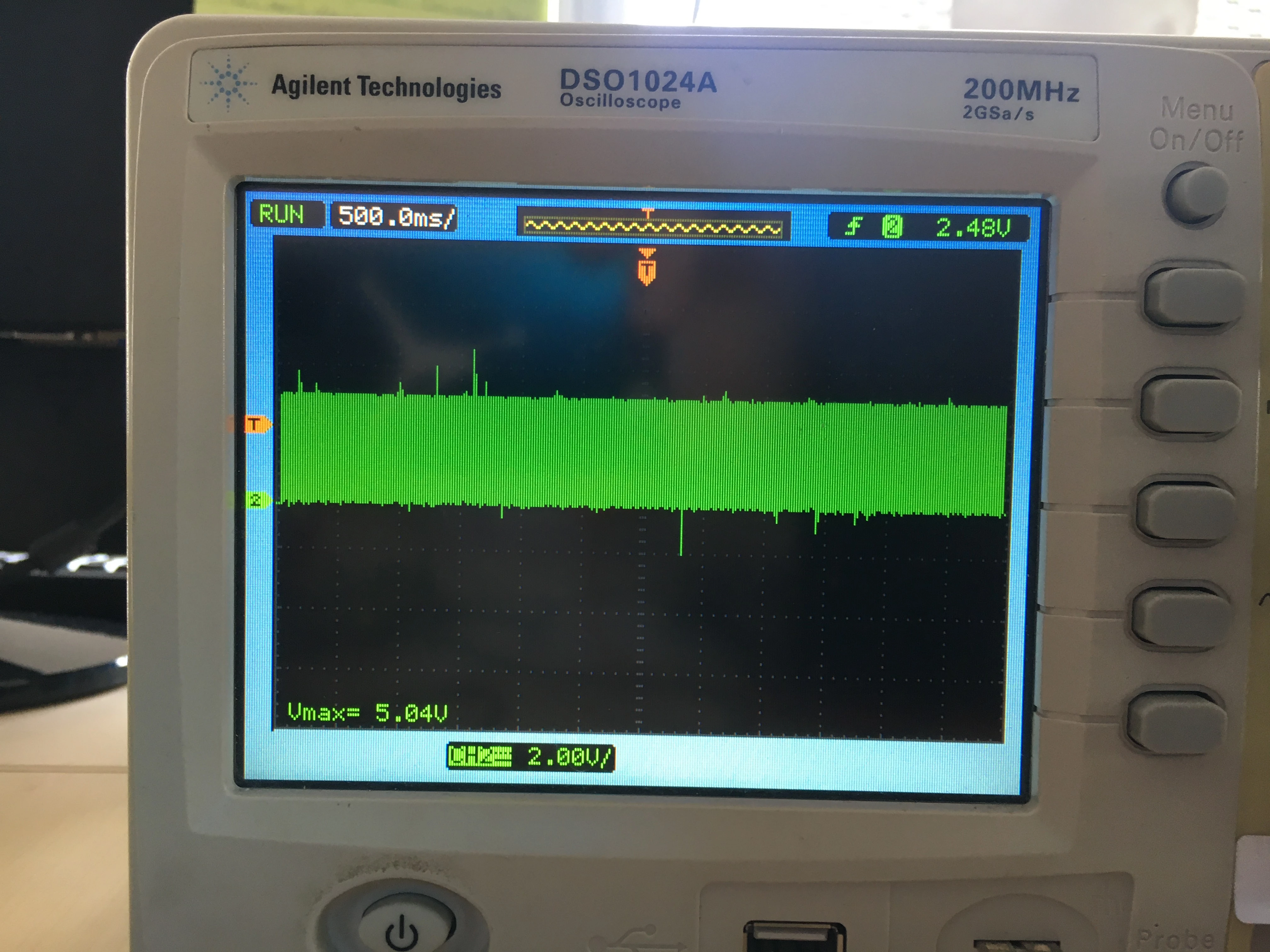

I'm using an oscilloscope and LEDs to test my code and functions.
GND pins are connected too.
TO begin, i only transmit from one card to the other one with the function hal_uart_transmit as shown as below :

for the other card connected to the other pc i change the function in the while by hal_uart_receive.

Thx for consideration ...

I forgot, i use STM32F767ZI ....
Tesla DeLorean
Guru
July 9, 2020
Have a common ground lead. While I suspect the USB might get you that, I'd prefer to see a board level bonding.
Neither of these transmit or receive functions will call the callback, they basically poll/block.
The IT variants on the other hand drop through, so you'll need to guard against calling them with data in-flight, but they would call the callback when the transfer is done.

I added a ground cable between the nucleos (the result is the same).
It's weird because when i compile and debug on STM32CubeIDE this main.c on one nucleo, i should see" Hello World !!! "on command shell console.....
while (1)
	 uint8_t Test[] = "Hello World !!!\r\n";
	 HAL_UART_Transmit(&huart2,Test,sizeof(Test),10);
	 HAL_Delay(1000);
 But nothing is happening.
Ok so to use callback functions i've to use the IT. I'll try to do that and i'll keep you informed of my result.
