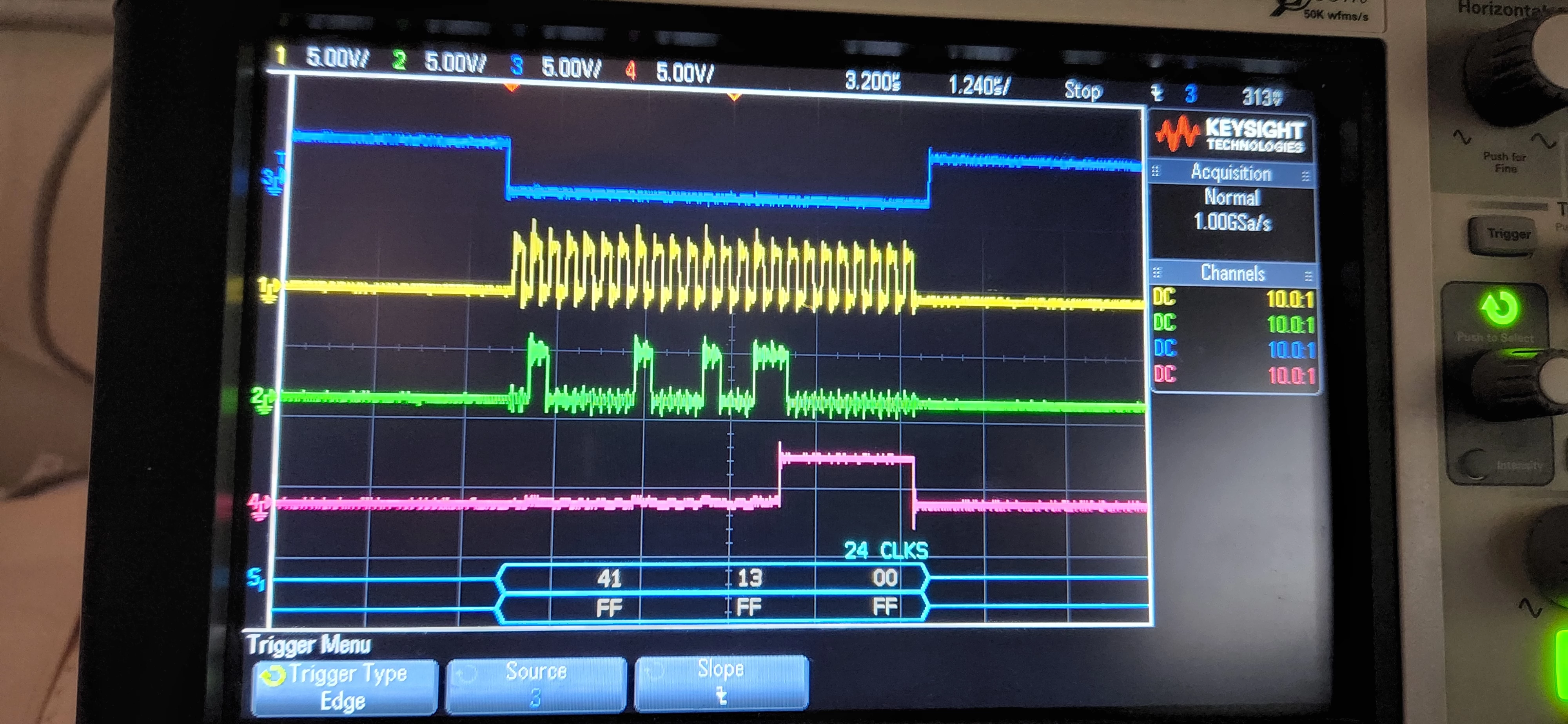

I am using NUCLEO-H723ZG and I am trying to use SPI the spi3 as SPI MASTER to the SPI SALVE device without success using DMA. I see the perfect data in the MISO line, But I unable to receive it into the "rx_buf", always "ZERO".

uint8_t mcp23s17_read_reg(uint8_t reg, uint8_t hw_addr)
  uint8_t control_byte = get_spi_control_byte(READ_CMD, hw_addr);
  uint8_t tx_buf[7] = {control_byte, reg ,0};
  uint8_t rx_buf[3] = {0, 0 ,0};
switch(HAL_SPI_TransmitReceive(&SpiHandle, (uint8_t*)tx_buf, (uint8_t *)rx_buf,(uint16_t) 3, 5000))
 case HAL_OK:
  break;
 case HAL_TIMEOUT:
  Timeout_Error_Handler();
  break;
 case HAL_ERROR:
  Error_Handler();
  break;
 default:
  break;
 // return the data
 return rx_buf[0];
