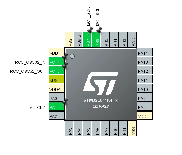

I am reading i2c data from temperature sensor. I need to convert i2c data that I got from sensor to PWM signal. I have generated PWM signal.
  • August 30, 2021
  • 1007 views
Right now, I am able to get I2C data from sensor. I have generated PWM signal separately with TIM_CH2. But I have no idea how to generate pwm from I2C signal. So, basically I need to control amplitude of pwm from i2c signal. I am using NUCLEO-L011K4 microcontroller development board which is STM32L011K4T6
Here my main part of code:

CubeMX selection of pins are attached here.

Tesla DeLorean
Guru
August 30, 2021
TIM2->CCR2 would control the PULSE WIDTH, in timer ticks, of the signal.
You'd need to come up with the 0-100% duty as it relates to the temperature range you want to represent, probably with some min/max duty limits.
NKaur.1
NKaur.1Author
August 31, 2021
Thanks for reply. Can you give any example for how to map TIM2->CCR2 to any signal.
