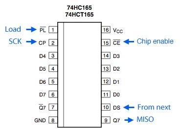

    T J
    Senior III
    December 25, 2017
    Posted on December 25, 2017 at 21:30
    Did you check if the F103 is 5V tolerant ?
    do you have a serial port for debug ?
    Digi key doesn't stock those parts anymore.
    Tesla DeLorean
    Guru
    December 26, 2017
    Posted on December 26, 2017 at 18:48
    The HC series parts should run fine at 3.0 or 3.3V
    The F1 family has most pins as FT (5V Tolerant), likely not the ADC pins, but the functionality is broken down in the Data Sheet via the pin list.
    Duy Khang Banh
    December 26, 2017
    Posted on December 26, 2017 at 13:48
    I use an STM32F103C8 development board and has onboard xtal, voltage regulator and works on a pc usb output voltage, I've managed to program the 74hc595 with this board. However, programming the counterpart parallel in, serial out (HC165) is quite hard for me. Could you or anyone tell me how I can read the bit from QH from the register?

    However the while function 'P1 = HC165();' can't be accepted since I use GPIO with help of the STMCubeMX. Instead of that, I write ' HAL_GPIO_WritePin(GPIOB, HC165(), GPIO_PIN_SET);'. However, after uploading the program there is no output. I use GPIOB, GPIO_PIN_0 till GPIO_PIN_7. I have a HIGH signal at QA so shouldn't it be alteast 1 led turned on?
