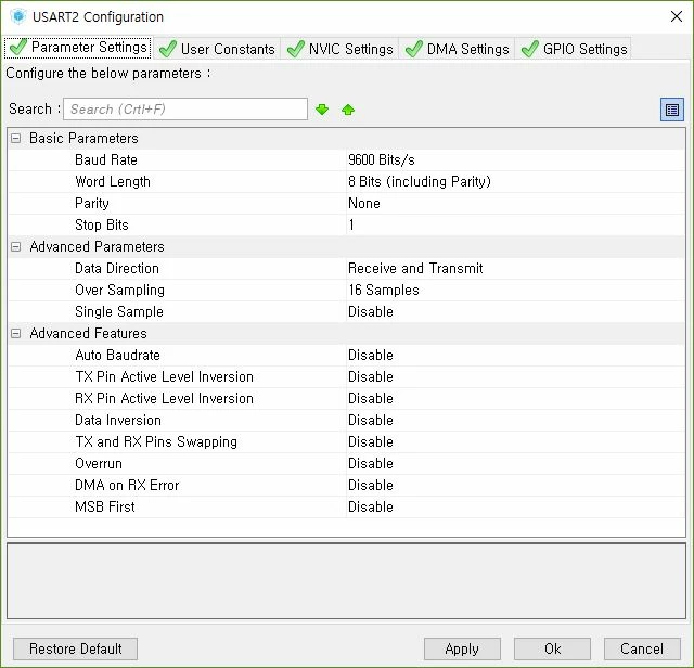

I'm stuck with the problem that any words are not printed in the teraterm.
I'm using STM32373C-EVAL board and trying to print words using serial port(CN12 connector).
I added function below to use printf function,
int __io_putchar(int ch) {
	uint8_t c[1];
	c[0] = ch & 0x00FF;
	HAL_UART_Transmit(&huart2, &*c, 1, 10);
	return ch;
int _write(int file, char *ptr, int len) {
	int DataIdx;
	for (DataIdx = 0; DataIdx < len; DataIdx++) {
		__io_putchar(*ptr++);
	return len;
and then I checked serial port number and baud rate etc.
But it still doesn't work.
Can you give me some advice to fix this problem? Did I miss some setting of UART or other point?

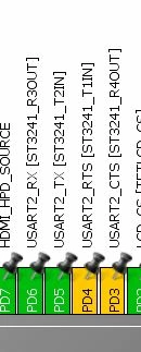

    HAL_UART_Transmit(&huart2, (void *)&ch, 1, 10);
    return ch;
    Check state of JP6
    Make sure you have the GPIO D and USART2 clocks enabled, and that PD5 and PD6 is properly configured, with the right AF selection.
    gsung
    gsungAuthor
    August 9, 2018
    Yes, I already checked everything like below.
    Do you have any recommendation to fix this problem?
    Tesla DeLorean
    Guru
    August 9, 2018
    I'd inspect the registers in the debugger, and signals with a scope
