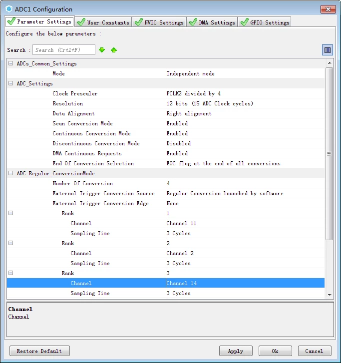

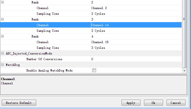

    Use DMA Mode to read multi-channel-adc looks fine,
    for example
    PC1 ------> ADC1_IN11,
    PC4 ------> ADC1_IN14,
    PA2 ------> ADC1_IN2,
    PC5 ------> ADC1_IN15:
    0690X00000606lrQAA.png0690X00000606mZQAQ.png1. ADC Initial : for channel with 4 different rank

    /**Configure for the selected ADC regular channel its corresponding rank in the sequencer and its sample time.
     sConfig.Channel = ADC_CHANNEL_11;
     sConfig.Rank = 1;
     sConfig.SamplingTime = ADC_SAMPLETIME_3CYCLES;
     if (HAL_ADC_ConfigChannel(&hadc1, &sConfig) != HAL_OK)
     Error_Handler();
     sConfig.Channel = ADC_CHANNEL_2;
     sConfig.Rank = 2;
     Error_Handler();
     sConfig.Channel = ADC_CHANNEL_14;
     sConfig.Rank = 3;
     Error_Handler();
     sConfig.Channel = ADC_CHANNEL_15;
     sConfig.Rank = 4;
     Error_Handler();

    4. Read Multi-ADC-Channel to memory
    static uint16_t adc_buffer[4];
    hadc1.Init.NbrOfConversion == 4
    if(HAL_ADC_Start_DMA(&hadc1, (uint32_t*)&adc_buffer, hadc1.Init.NbrOfConversion) != HAL_OK);
     HAL_Delay(500);
    HAL_ADC_Stop_DMA(&hadc1);
    and add what you want in completed callback function:
