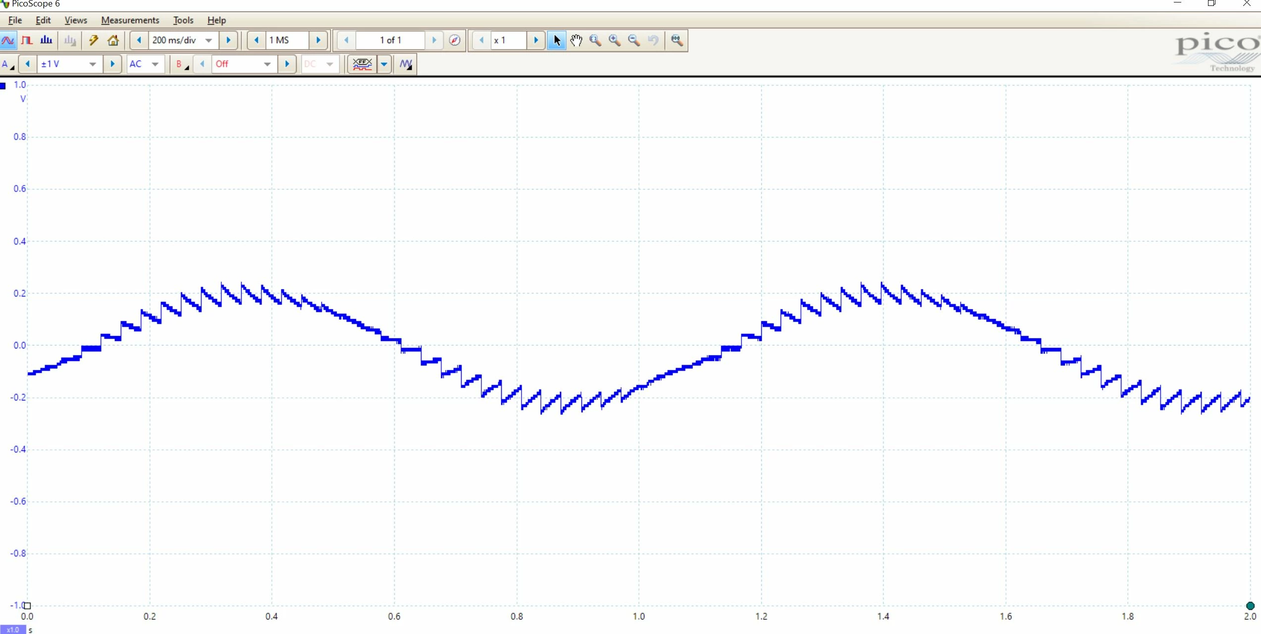

I am testing OPAMP_PGA example code.
Here is the DAC config code:
 /** DAC channel OUT1 config
 sConfig.DAC_HighFrequency = DAC_HIGH_FREQUENCY_INTERFACE_MODE_AUTOMATIC;
 sConfig.DAC_DMADoubleDataMode = DISABLE;
 sConfig.DAC_SignedFormat = DISABLE;
 sConfig.DAC_SampleAndHold = DAC_SAMPLEANDHOLD_DISABLE;
 sConfig.DAC_Trigger = DAC_TRIGGER_T2_TRGO;
 sConfig.DAC_Trigger2 = DAC_TRIGGER_NONE;
 sConfig.DAC_OutputBuffer = DAC_OUTPUTBUFFER_ENABLE;
 sConfig.DAC_ConnectOnChipPeripheral = DAC_CHIPCONNECT_BOTH;
 sConfig.DAC_UserTrimming = DAC_TRIMMING_FACTORY;
 if (HAL_DAC_ConfigChannel(&hdac1, &sConfig, DAC_CHANNEL_1) != HAL_OK)
 Error_Handler();
The DAC output drops very fast once it is raised to the expected value as showed in the following pic:
0693W00000GWf1rQAD.jpgI change this line
to enable sample and hold. It does not help much.
I wonder what are the proper values for these parameters
 sConfig.DAC_SampleAndHoldConfig.DAC_SampleTime = 0;
 sConfig.DAC_SampleAndHoldConfig.DAC_HoldTime = 0;
 sConfig.DAC_SampleAndHoldConfig.DAC_RefreshTime = 0;
So DAC output can hold until next change trigger

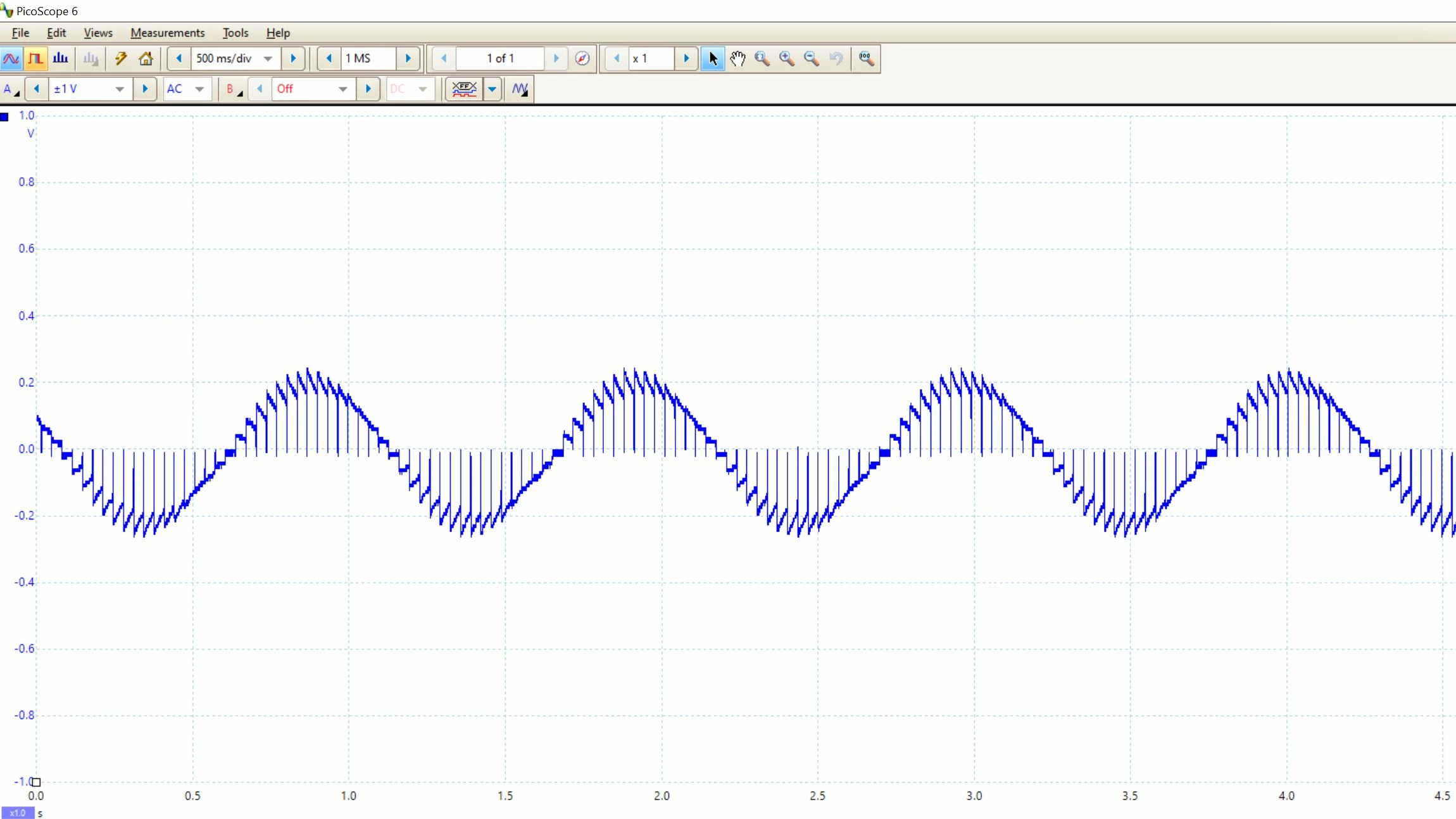

According to stm32g4xx_hal_dac.h, max value for SampleTime and HoldTime is 1023.
So I set those 3 parameters as
 sConfig.DAC_SampleAndHoldConfig.DAC_SampleTime = 1023;
 sConfig.DAC_SampleAndHoldConfig.DAC_HoldTime = 1023;
This is DAC output as captured in scope:
