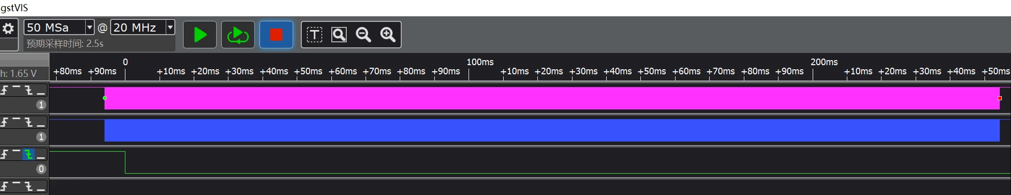

BZhu.4
BZhu.4Author
August 9, 2022
0693W00000QNFlvQAH.pngWhat said in last comment is not accuracy. From the logic analyzer, the interrupt pin is always pulled low.
If use the ​following code, it's OK.
HAL_NVIC_DisableIRQ(EXTI9_5_IRQn);
//atomtic operation
HAL_NVIC_EnableIRQ(EXTI9_5_IRQn);
