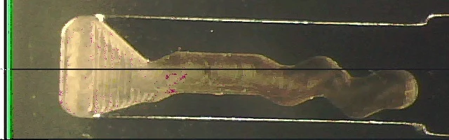

    yesil_kaya76
    September 26, 2013
    Posted on September 26, 2013 at 15:28
    thanks alot fm for your suggestion. I found a new way for VGA format. I captured two pictures from camera without FIFO. After i combined this pictures as follow.
    But, there are a problem. i dont removed black line in the middle of the Picture.
    Black end White is a good idea. But as far as I know, camera does not support grayscale.
    it supports just; YUV, RGB and RAW.
