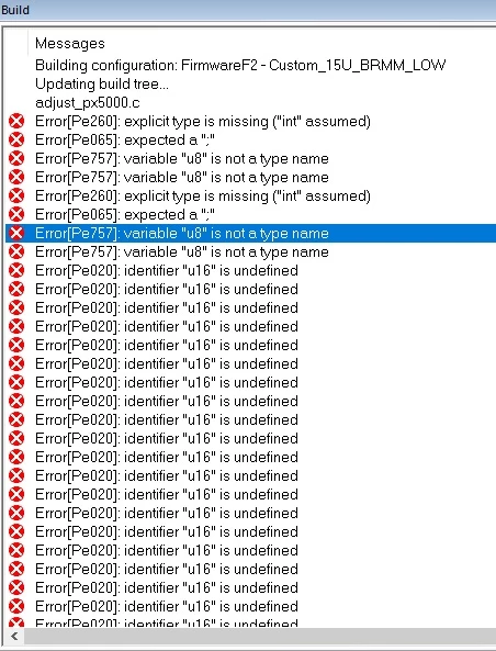

I'm having a brain fart and can't figure this out. I'm porting an existing project from the STM32F205 series to the STM32L496 series. So I replaced "system_stmf2xx.c" with "system_stml4xx.c" in my project workspace, but my compiler (IAR) isn't picking it up. It looks like the startup_stm32l496xx.s assembly file is making calls into the system file. So where is the startup file included?

The error(s) are actually about variable types being undefined: u8, u16, etc. These are all defined in stm32l4xx.h, so I deduced that's not being included. That header gets called out in system_stm32l4xx.c. system_stm32l4xx.c should actually have about 30 header files under it in the project tree if it was being included properly. I have none.

It's going to be easier if you show the exact error message.

0693W00000DqFsnQAF.jpgHere's some of them.

As you see, stm32l4xx.h does not define types "u16", "u8" etc. It rather uses stdint.h.
Also, system_stml4xx.c does not include a lot of .h files.
https://github.com/STMicroelectronics/cmsis_device_l4/blob/master/Source/Templates/system_stm32l4xx.c
Confused? the messages come from compiling some other .c file, not system_stml4xx.c

Sure looks like the error messages are from "adjust_px5000.c" and not from a system startup file.
