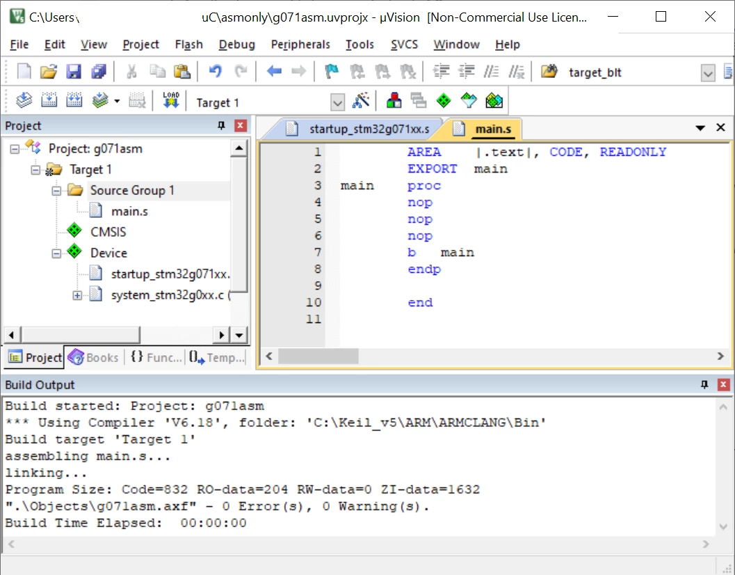

Dear
I appreciate if someone leads me to learn how to create an assembly program within KEIL uVision 5.
I develop on STM32F030 series micro-controllers.
Is it possible in older versions, i.e. uV 4, uV 3, ... etc?
Best Regards!

When you create a project with Keil, it does not even create a main function. You may simply write your main function in assembly language instead of C.
Another question is why would anyone do that. An average compile for ARM usually writes better, more compact and faster code than an average assembly programmer. ARM is not an assembly-programming friendly architecture.

Perhaps take and example/template project, clone into another directory, and do you Assembler work directly into the startup.s file.
Failing that, read some of the documentation, or find tutorials or videos, doubt you're charting new territory here.

ChahinezC
October 20, 2022
Hello @ihartavi​,
Welcome to ST community.
I think you can find a project that can help you here.
Regards,
Chahinez.
